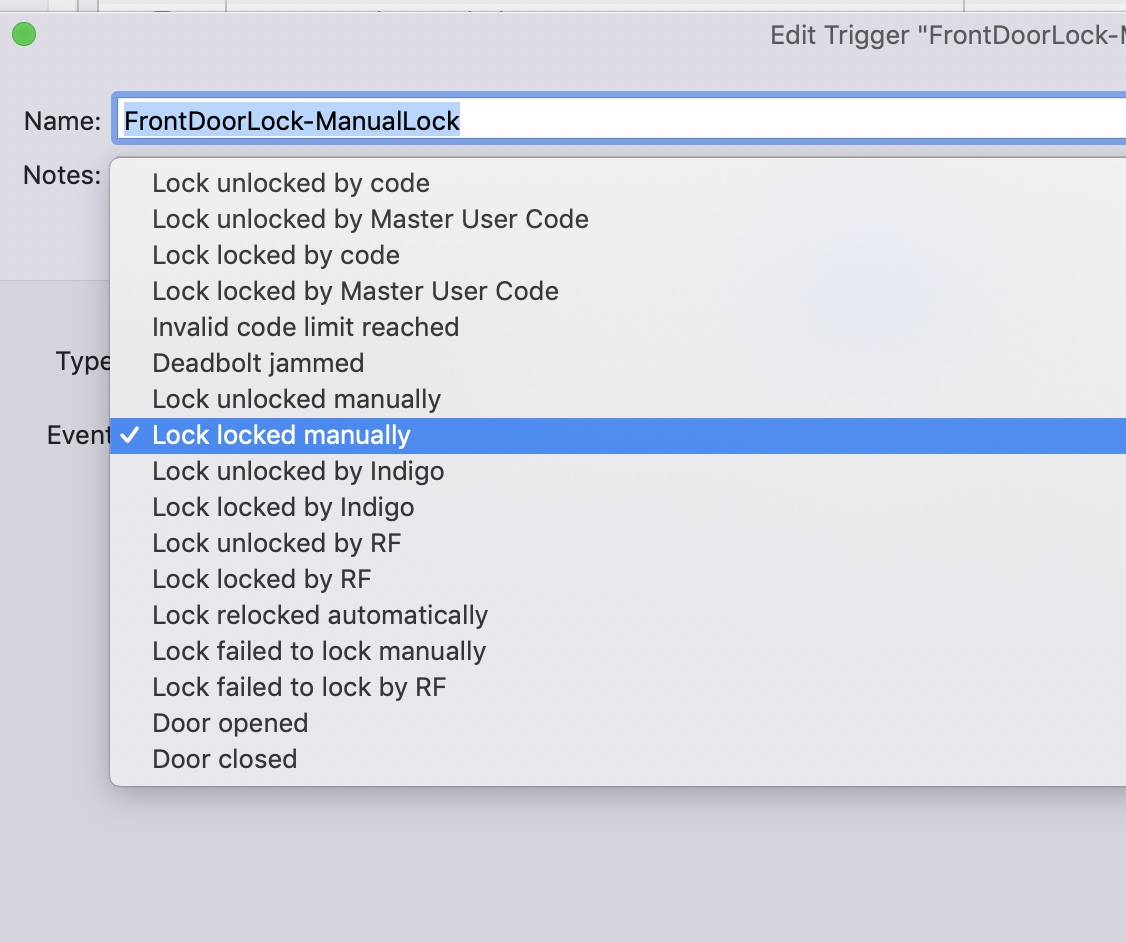

Is there a way to have a trigger when the lock is locked from outside only. It does give me 2 different messages:
From inside:
Z-Wave Lock Manager Status: Door locked manually [Node: 33]
From outside:
Z-Wave Lock Manager Status: Door locked manually (one-touch button) [Node: 33]
Manual lock event from outside
Re: Manual lock event from outside
Doesn't seem to be there. Thanks!howartp wrote:If it’s not there now, I can certainly add it.
- Screen Shot 2019-08-11 at 2.52.26 PM.jpg (192.23 KiB) Viewed 2713 times
Give this a try:
https://github.com/howartp84/ZWaveLockM ... tag/1.0.53
It's untested but should work.
Peter
Peter
Awesome, that worked! Thank you!!howartp wrote:Give this a try:
Peter
