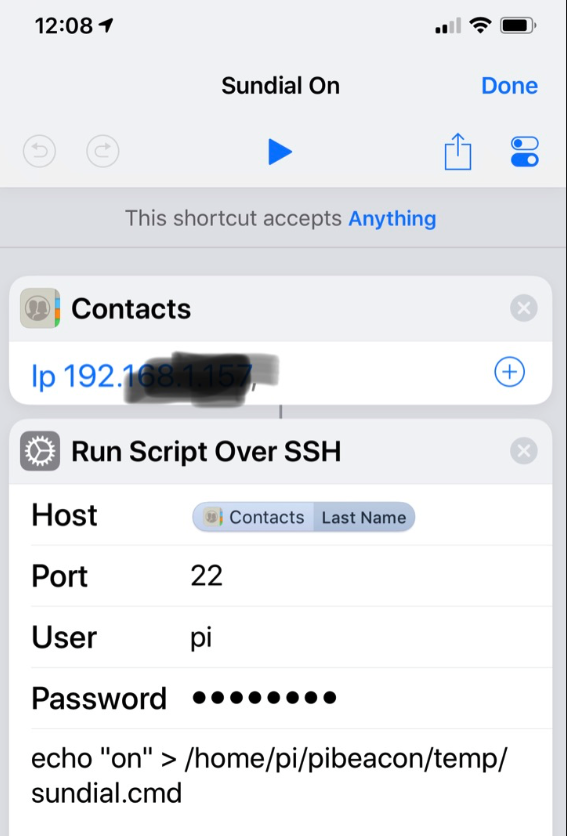

looks like iOS shortcuts do NOT have persistent / global variables..
But here is what seems to work:
A)
1. create a contact "ip" with last name = 192.168.x.x
B) in shortcuts:
1. contacts: select specific contact (ip number)
2. ssh: in hosts field select details of contact = last name
.. fill out userid, password and command
then there have several shortcuts with different commands
here the iPhone screen shot
Screen Shot 2019-07-24 at 12.10.43.png (196.58 KiB) Viewed 4719 times

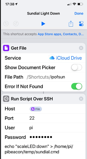

Re: iOS shortcuts
more more comment:
it seems that shortcuts do not re-read the input apps, ie when changing the contact info the shortcuts continue to use the old info.
Even deleting the contact does not change the behavior of the shortcuts.
Using file info seems to work fine. When files are deleted , the shortcuts fail, when recreating them they work fine again.
So here the version that seems to be working well...
Screen Shot 2019-07-24 at 17.41.23.png (94.13 KiB) Viewed 4684 times
Although it is a little difficult to create a file in the shortcuts folder - first get a file editor. create the file with contents 192.162.x.x , then use files to move / copy the file into the shortcuts folder.
