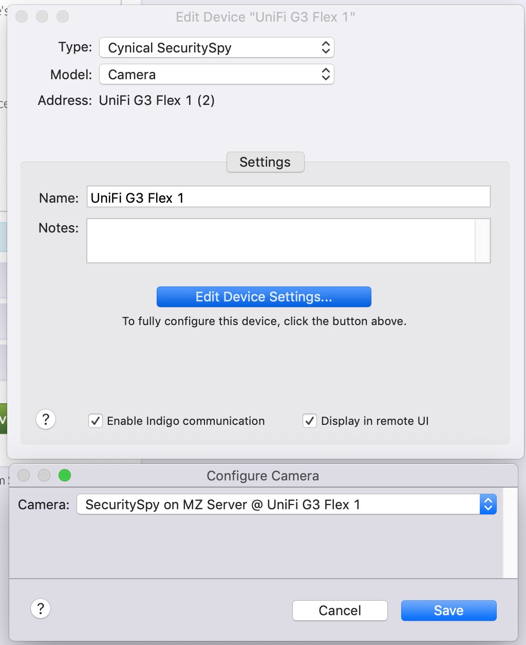

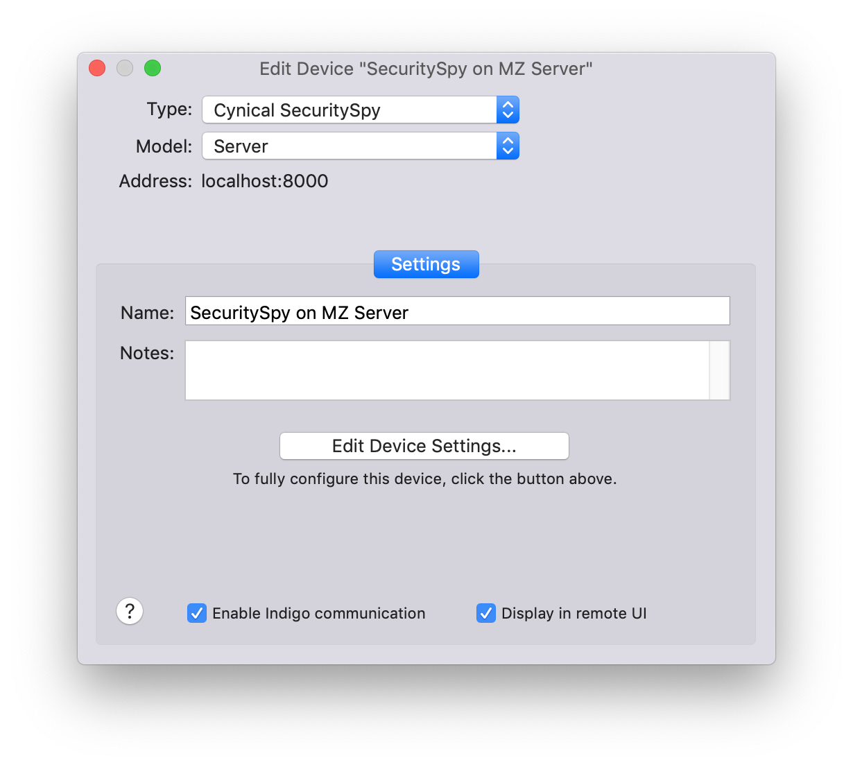

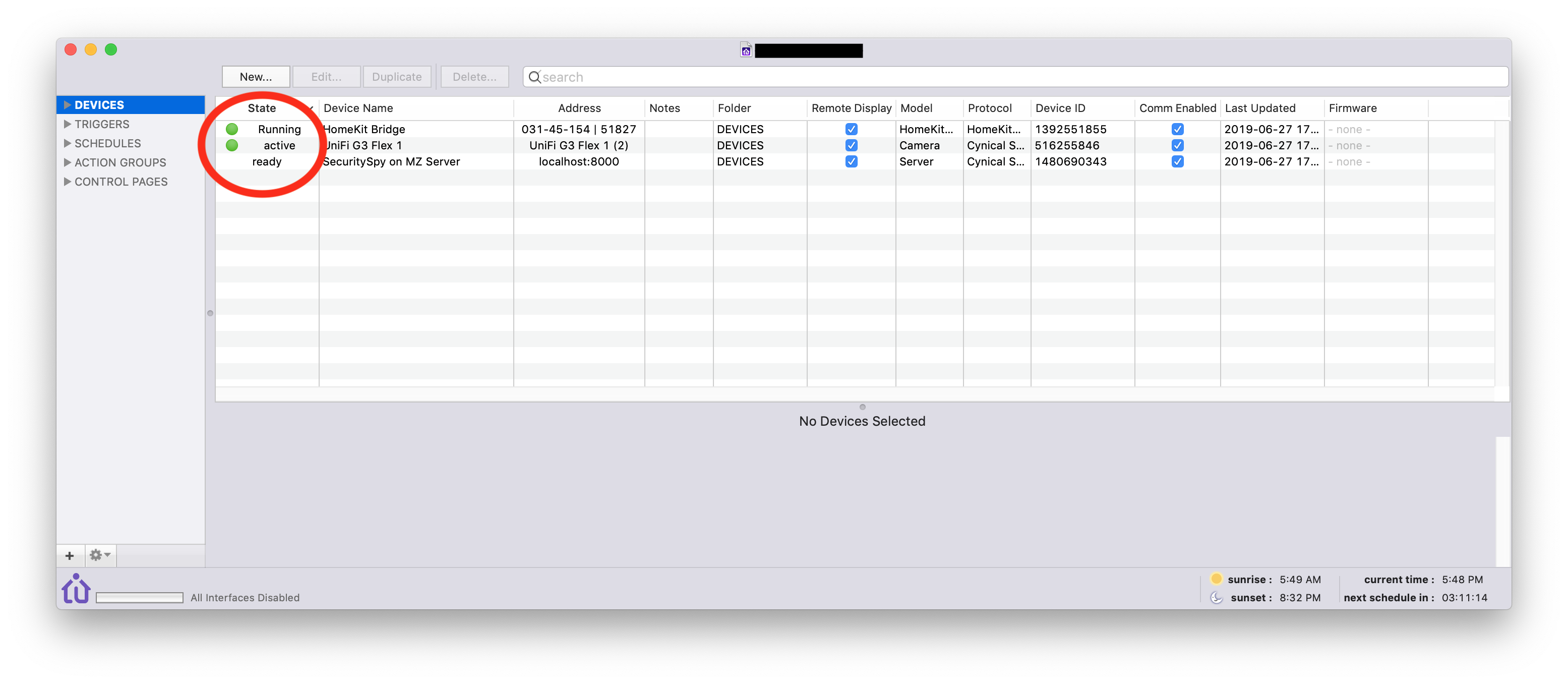

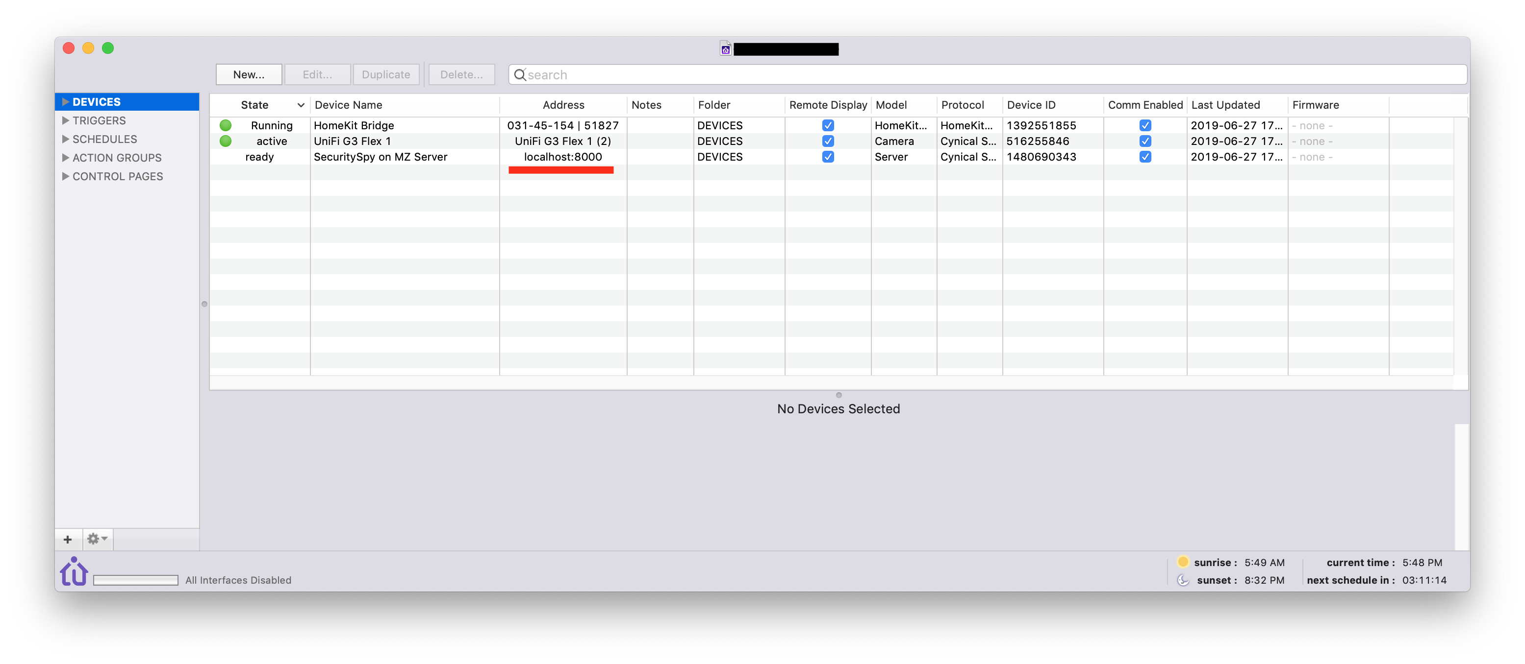

3. Cynical SecuritySpy plugin installed and running in Indigo has a "server" and "camera" devices added in Indigo (believe I have the Cynical plugin setup correct as when I go to add a new "camera" device in Indigo it seems my existing SecuritySpy cameras so think I'm good there)

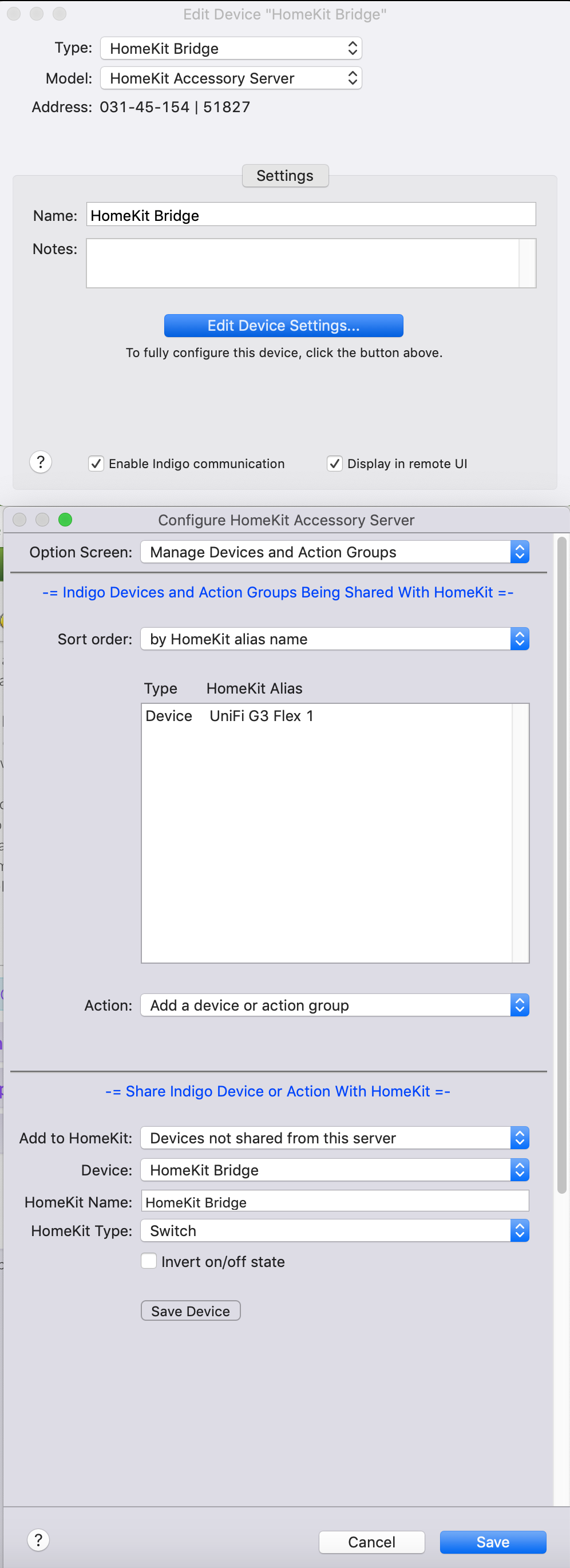

4. HomeKit Bridge plugin installed and running in Indigo with my "camera" device (added via the Cynical SecuritySpy plugin) added to be visible in HomeKit
5. All 3 devices in Indigo are enabled (see screenshot)

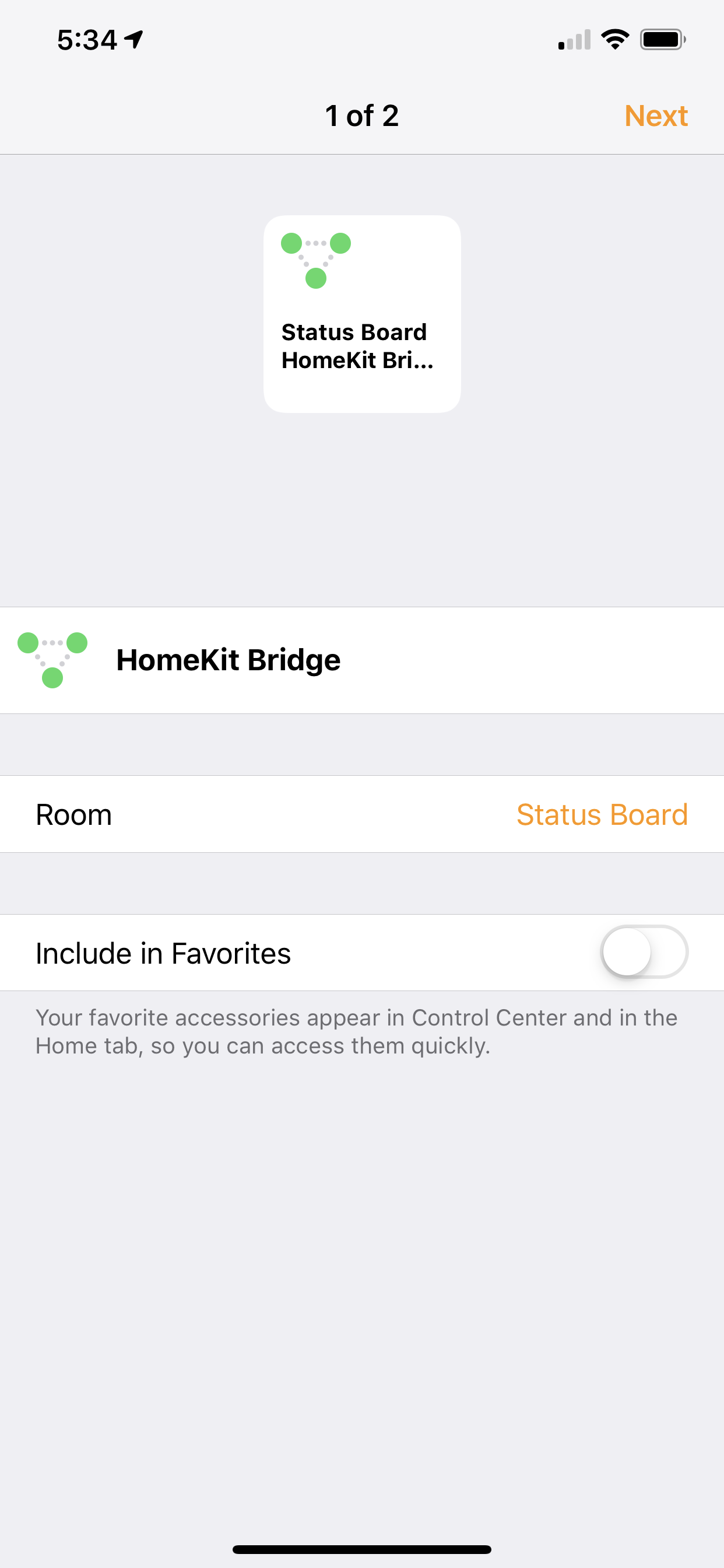

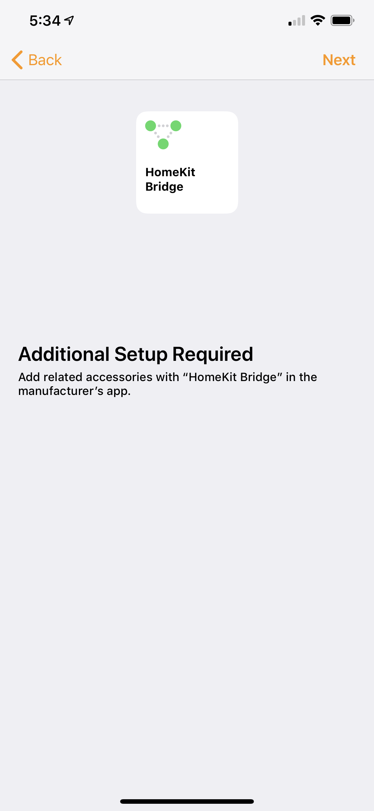

6. On my iPhone I am able to add the HomeKit Bridge via the Home App while using the HomeKit code provided by the plugin in Indigo
7. The bridge is added but notes that "Additional Setup Required" when it's added (seems strange but okay...)

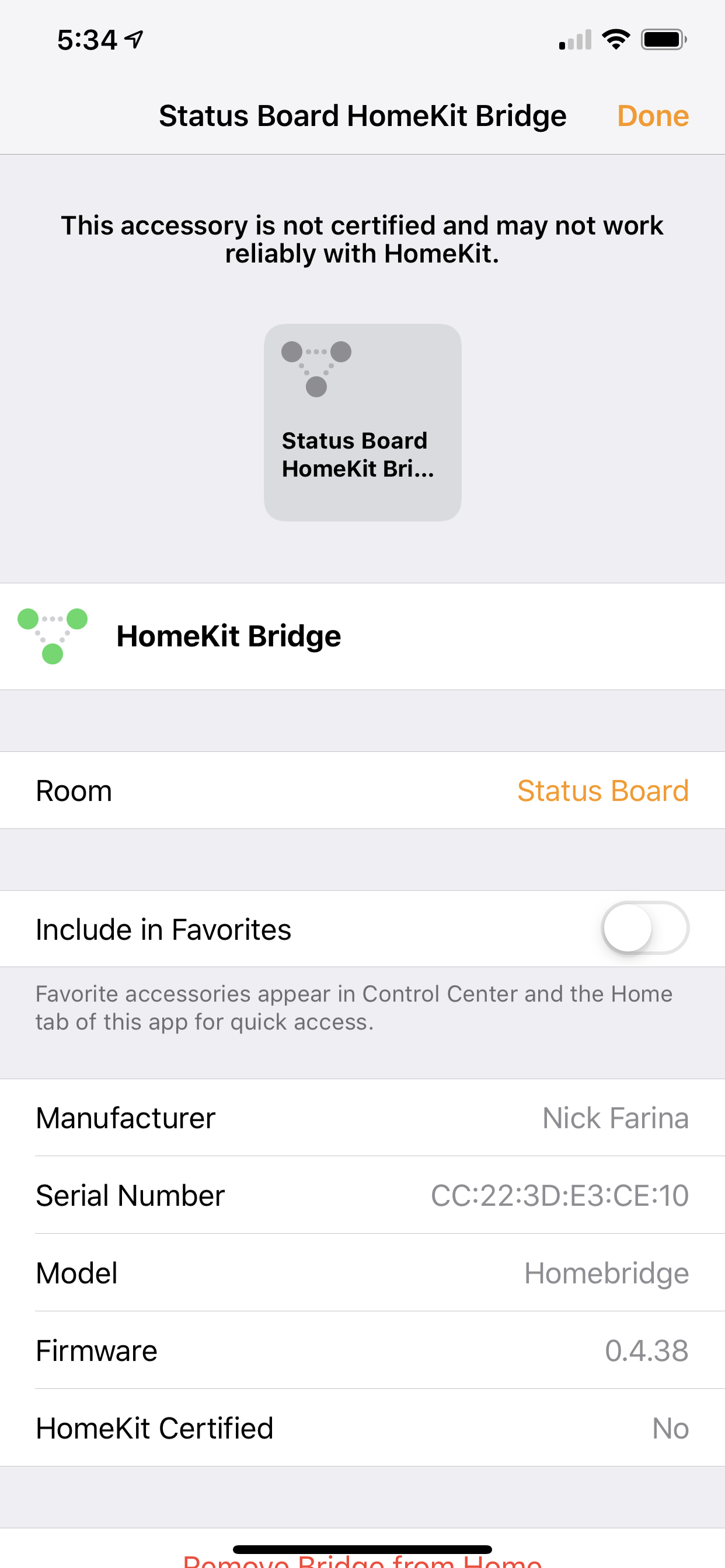

8. The settings of the bridge in the Home app all look correct

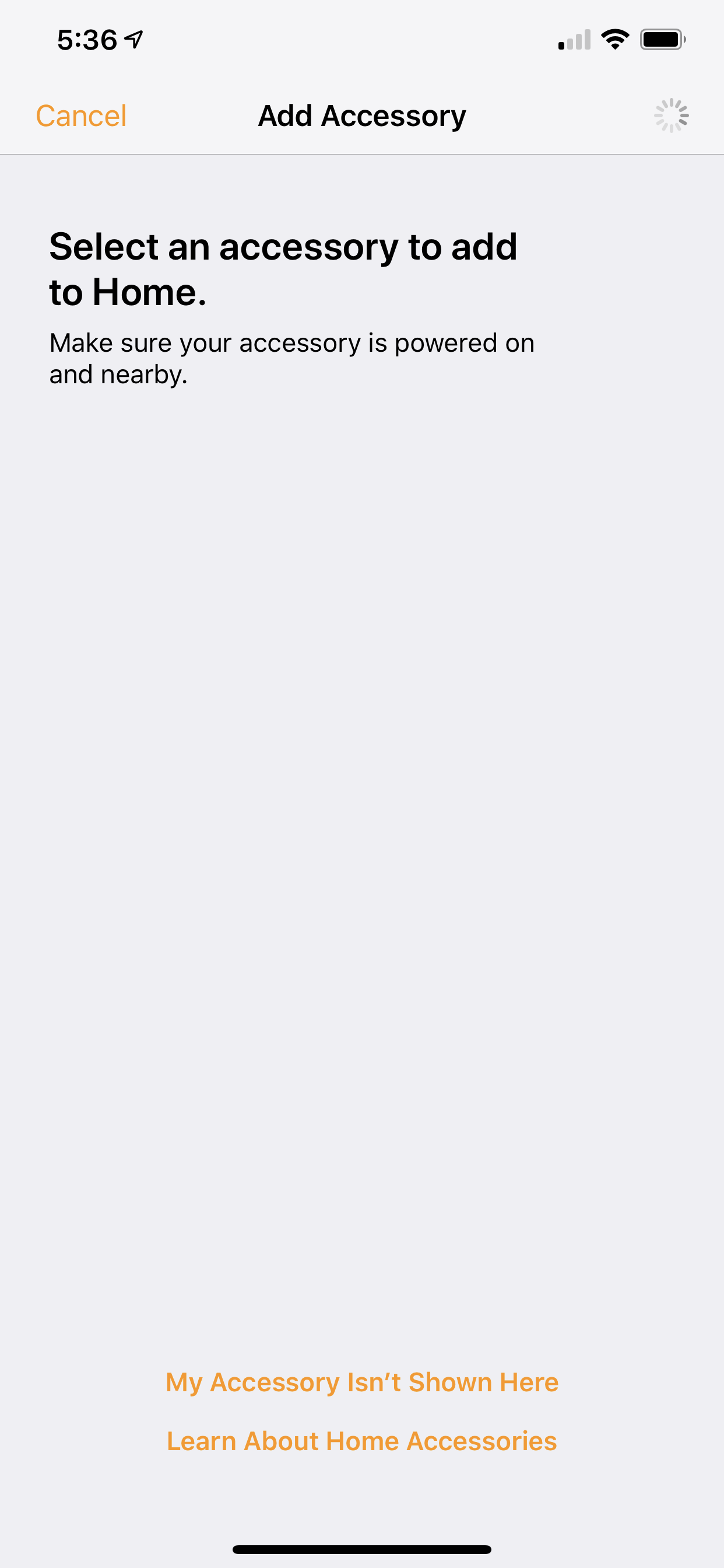

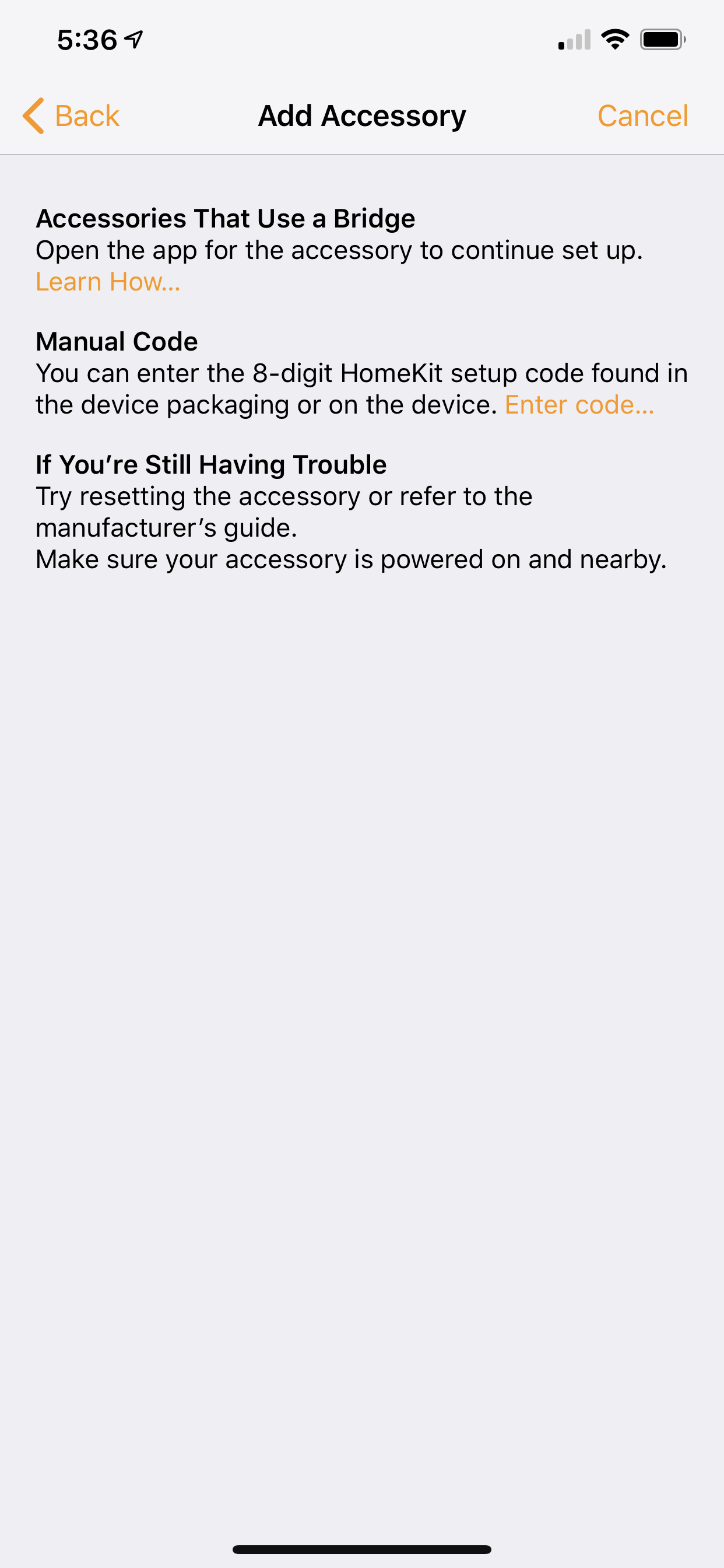

9. I know cameras need to be added to the Home App individually so going back to add another Accessory I choose "Enter code..." and enter the HomeKit code provided by the plugin in Indigo again
10. Unfortunately no camera accessories are visible and the Home App just spins but never finds them :(
