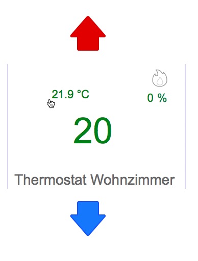

Got it:
As I said I made a control to increase and decrease the setpoint.
The action is "decrease TRV Setpoint by 0.5 degrees".
After I clicked four times in a row, the setpoint odf the thermostat dropped to 8.0
So it's a timing problem.
Maybe it's a good idea to just decrease a counter and update the thermostat later in the background.
12.05.2019 18:52:18
WebServer request to execute "iPad Heizung" control #6 from 192.168.1.15
Z-Wave sent "Thermostat Wohnzimmer" change heat setpoint to 22.5°
Z-Wave sent "Thermostat Wohnzimmer" change heat setpoint to 22.0°
Z-Wave sent "Thermostat Wohnzimmer" change heat setpoint to 8.0°
- Bildschirmfoto 2019-05-12 um 18.54.43.JPG (22.03 KiB) Viewed 5092 times
