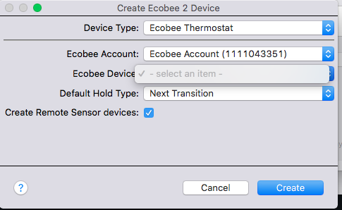

I've installed the Ecobee v2 2.2.0 plugin and successfully created an 'Ecobee Account' device, as outlined at https://github.com/FlyingDiver/Indigo-Ecobee-2
Pretty sure that's configured correctly, because: 1) when I log into https://www.ecobee.com/consumerportal and look at My Apps, I see the "Ecobee Indigo Plugin Version 2" listed; 2) the Custom State of the Ecobee Account device shows as 'Authenticated'; 3) all communication between the GUI at the consumer portal and my thermostat works (i.e. when I change the set temperature on either my thermostat or the web site, the other registers the action)
However, when I try to create a new Ecobee thermostat device, I have a problem. I set the device type to Ecobee 2, and the 'Create Ecobee 2 Device' window pops up. It's Device Type: is set to Ecobee Thermostat, which is expected. The Ecobee Account: popup shows the correct Ecobee Account from above. But the Ecobee Device: popup shows "- select an item -" and when I click on it there are no other options, it's an empty list.
Thanks, Bruce
Screen Shot 2019-03-29 at 2.35.12 PM.png (46 KiB) Viewed 7507 times

Re: Ecobee thermometer not showing during device creation
I'm not sure what you've got going on. Those log excerpts show that the plugin is seeing one thermostat and one remote. But something seems to have gone wrong with the device creation so that it's not using the right account device.
Delete both the thermostat and the remote. Restart the plugin. Try to create them. If the dialog box doesn't show any devices available to create, then open the config dialog and save it, then try to create it again.

Fixed.
I'd been working inside a folder of devices ("HVAC") that I thought held all my Ecobee devices. But no, there was a Ecobee thermostat device lurking in the general Devices folder. And, because that was tied to the real thermostat, the plugin [correctly] saw there were no available thermostats.
I deleted the rogue thermostat (not sure how it got there or when I created it, but I'll have to admit guilt) and was immediately able to create a new thermostat device.
Everything working as desired now.
Thanks for your help!
Bruce

Is that the complete log after a plugin restart? With debug logging turned on? Because you should see something like this:
   Starting plugin "Ecobee 2 2.2.0" (pid 18571)
   Ecobee 2 Debug                  logLevel = 10
   Started plugin "Ecobee 2 2.2.0"
   Ecobee 2                        Starting Ecobee
   Ecobee 2 Debug                  macOS 10.13.6, Indigo 7.3.1
   Ecobee 2 Debug                  updateFrequency = 900.0
   Ecobee 2 Debug                  setting temperature scale to F
   Ecobee 2                        Ecobee Account (363954845): Starting EcobeeAccount Device 363954845
   Ecobee 2 Debug                  Ecobee Account (363954845): EcobeeAccount __init__, using refresh token = j2TmXO1aNLkW1Nl3uXc9FVEQnAzotWup
   Ecobee 2 Debug                  Token Request with refresh_token = j2TmXO1aNLkW1Nl3uXc9FVEQnAzotWup
   Ecobee 2 Debug                  Token Refresh OK, new access_token = a0Ewe8mLN8IAH9hoKo5KUGqaru87otFZ, new refresh_token = IjRuPSjYJWcb9hykoWDo8RLIbRIPhykH, expires_in = 3599
   Ecobee 2 Debug                  runConcurrentThread starting
   Ecobee 2 Debug                  Ecobee Account (363954845): Ecobee Account Update OK, got info on 4 thermostats
It's that last line that's important. That's how many thermostats the Ecobee server thinks you have.
Make sure your plugin is up to date, then restart the plugin (debug logging enabled) and repost the results.

This showed up this morning after an interface restart (power outage) and I could add my Thermostat back (which automatically added the sensors). I don't know if there was a problem on Ecobee's end, or if it had something to do with restarting the interfaces (although I cycled the server multiple times yesterday).
Bottom line - everything is working fine now.

   Ecobee 2 Threaddebug            Thermostat Update, thermostats =
    "311036044941": {
        "actualHumidity": 51,
        "actualTemperature": 719,
        "brand": "ecobee",
        "climates": {
            "away": "Away",
            "home": "Home",
            "sleep": "Sleep",
            "smart1": "Evening"
        "currentClimate": "home",
        "desiredCool": 720,
        "desiredFanMode": "auto",
        "desiredHeat": 690,
        "equipmentStatus": "",
        "fanMinOnTime": 0,
        "features": "Home,HomeKit",
        "hvacMode": "auto",
        "internal": {
            "humidity": "51",
            "occupancy": "false",
            "temperature": "709"
        "latestEventType": null,
        "modelNumber": "athenaSmart",
        "name": "Main Floor",
        "remotes": {
            "JJCQ": {
                "name": "Craft Room",
                "temperature": "741",
                "thermostat": "311036044941"
            "PKTK": {
                "name": "Bedroom",
                "occupancy": "true",
                "temperature": "720",
            "R86G": {
                "name": "Lil'bee",
                "temperature": "784",
            "X3XP": {
                "name": "Living Room",
                "temperature": "718",
sensors = {
    "JJCQ": {
    "PKTK": {
        "name": "Bedroom",
    "R86G": {
        "name": "Lil'bee",
    "X3XP": {
Hap
Posts: 74
Joined: Sun Jul 28, 2013 6:02 pm
Location: Huntsville, AL
Post by Hap »
Oh and this is all I got in the logs when the plugin started when it wasn't working, The line you were looking for wasn't there.
   Ecobee 2                        Ecobee Account (1942762185): Starting EcobeeAccount Device 1942762185
   Ecobee 2 Debug                  Ecobee Account (1942762185): EcobeeAccount __init__, using refresh token = jFu4NIioOJVqi4gjt1wLpciTp3AnhAJP
   Ecobee 2 Debug                  Token Request with refresh_token = jFu4NIioOJVqi4gjt1wLpciTp3AnhAJP
