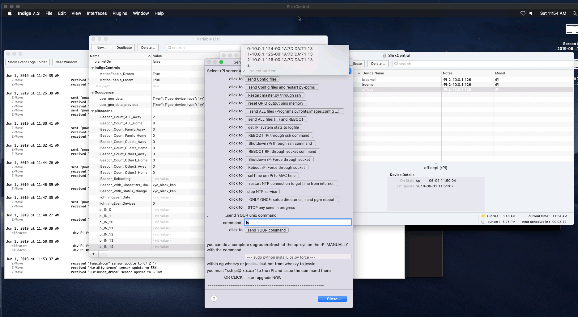

Figured it might be time to try this again. so, I have three pi's running piBeacon, 2 model 3b's and 1 model 3b+. I've inserted a BLE dongle into all of them, and currently have them set to let piBeacon decide which one to use for all three. Running pibeacon 7.105.280 on indigo, with one of your images from 12-09-2018 for all three pi's.
I noticed that when I try to push files to the pi's from piBeacon, the drop down shows the same address for all three. Is this expected as just part of the UUID, or is this an issue? Last time I saw this, piBeacon would seem to associate two devices to the same node, so results were unexpected. I removed everything, deleted the plugin and prefs, and reinstalled, and now see this duplication again. I attached a screenshot of the GUI, as I couldn't figure out how to insert an image inline here. doh..
I also noticed the following errors recurring in the plugin.log, which makes me think this duplication could be confusing piBeacon as well:
12:08:19 rPi#: 0 >>10.0.1.125<< ip number has changed, please fix in menue/pibeacon/setup pi or changed Ip number or send restart to rPi; old >>10.0.1.124<< received from pi: >>10.0.1.125<<
10.0.1.124 = pi0 = pi3b
10.0.1.125 = pi1 = pi 3b
10.0.1.126 = pi2 = pi 3b+
I have them connected to the network via wlan0, but eth0 is up on both of them for a different network:
pi0: wlan0 = 10.0.1.124, eth0 = 10.0.124.1
pi1 wlan0 = 10.0.1.125, eth0 = 10.0.125.1
pi2 wlan0 = 10.0.1.126, eth0 = 10.0.126.1
I notice that the system keeps changing /home/pi/pibeacon/ipAddress to the eth0 interface ip, then i see an error regarding the ip has changed, so i edit that file and reboot. That tends to fix it, though sometimes it comes back. Not sure if that really matters, but I think it's best to have pibeacon looking at the wlan0 address since there's no hop involved. Should i do anything differently there?
So, I guess I see two potential issues. 1) the system wants to use eth0 for the pibceaon/ipAddress, instead of wlan0 and 2) those duplicate IDs for the pi's potentially causing the system to see all devices as the same pi. Any thoughts, suggestions here?
thanx,
~ken
Screen Shot 2019-06-01 at 11.54.33 AM.png (248.22 KiB) Viewed 6023 times
