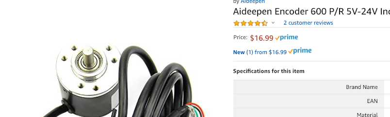

Also got this one to work.. although 600 steps/360degree is too much .
Screen Shot 2019-02-04 at 17.47.16.png (109.48 KiB) Viewed 3420 times
suggest to use a lower resolution version like: " Qauick 100p/r Incremental Rotary Encoder Dc5-24v Wide" 660 down to 100 steps/ 360 degree
Added a simple diode (eg 1N914) into the signal line (cathode to the device, anode to the GPIO; cathode has a black ring) just for safety. as this device really needs +5V - does not work w 3.3V
Although it looks as if the signal voltage does not go over 3.3V. The device is sealed so you don't know exactly what's in there.
[edit] 2 rotate switches same time on the same RPI seem to work fine (different GPIOs naturally)[/edit]
