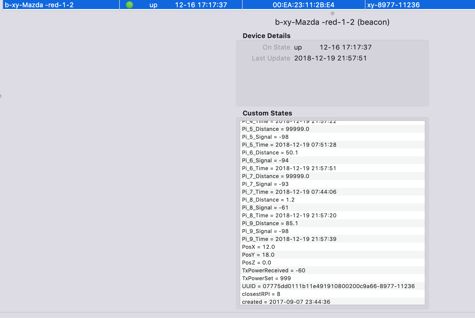

In the iBeacon device states.
Move the states View pane up
There you find some 30+ states

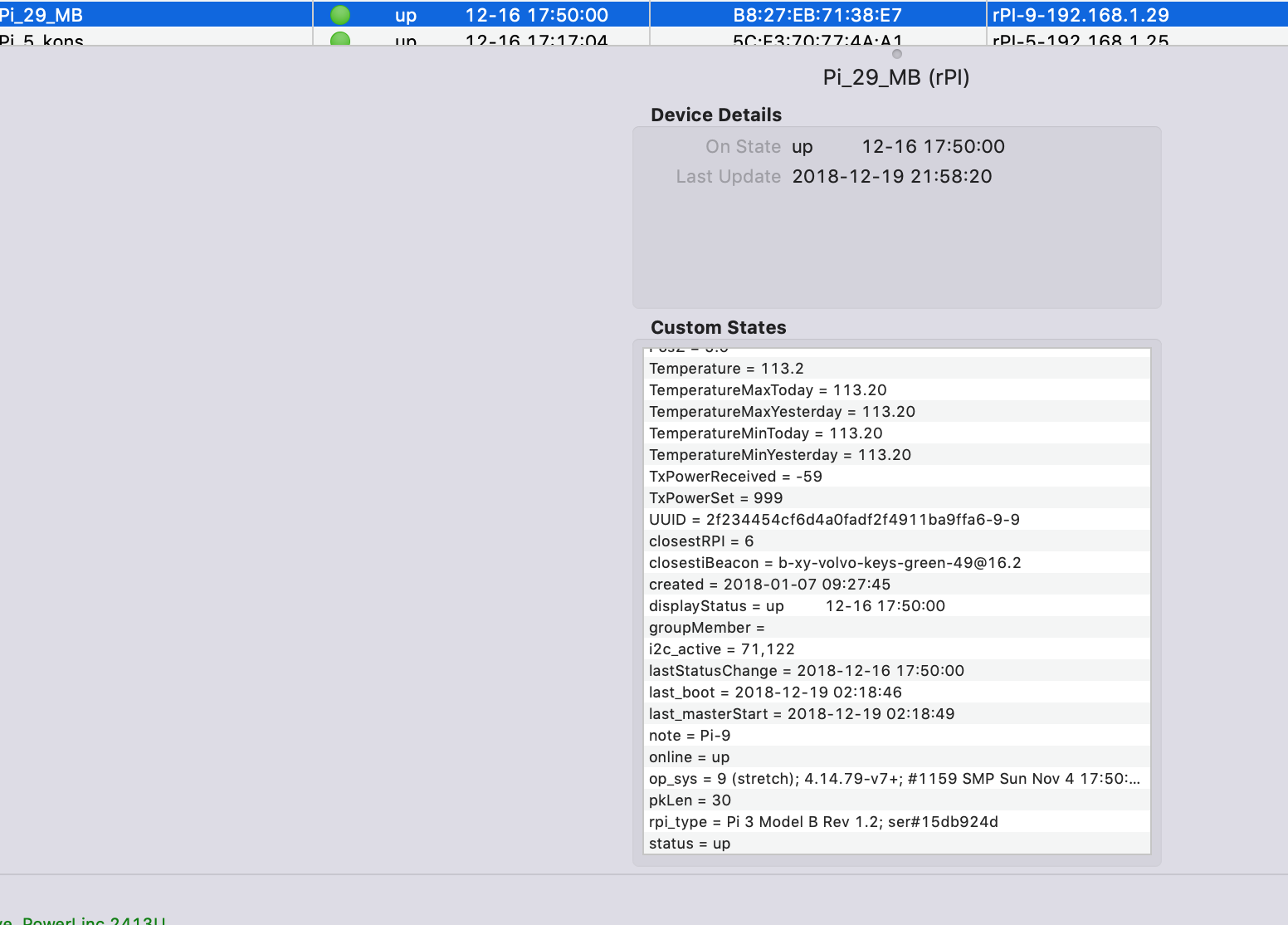

In rpi device states you find the nearest iBeacon

- Screen Shot 2018-12-19 at 9.57.52 PM.png (176.91 KiB) Viewed 2350 times
- Screen Shot 2018-12-19 at 9.58.20 PM.png (196.14 KiB) Viewed 2350 times

Oh my, such a simple thing and never seen that you could pull up that spit window.
thanks so much
