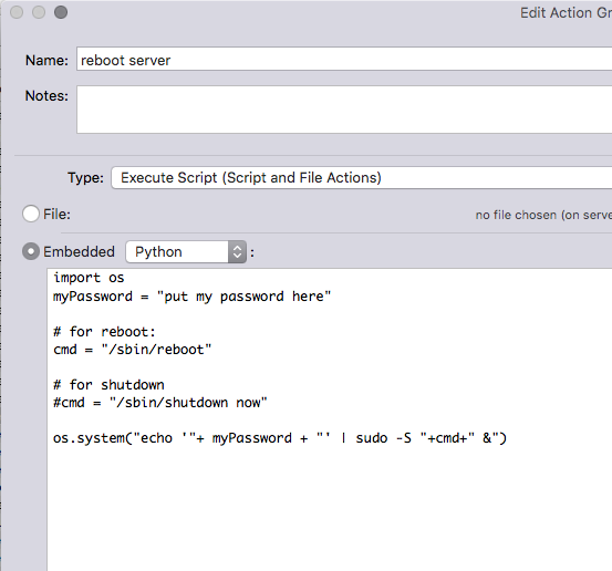

action to reboot / shutdown server
put this into an action / server / execute script :
import os
myPassword = "put my password here"
# for reboot:
cmd = "/sbin/reboot"
# for shutdown
#cmd = "/sbin/shutdown now"
os.system("echo '"+ myPassword + "' | sudo -S "+cmd+" &")
when executed the mac indigo server will reboot or will shut down depending on the option chosen.

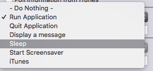

Mac Commander also does this as well as lets you run anything on a remote Mac.
Check Them Out Here
Re: action to reboot / shutdown server
@Colorado4Wheeler.. downloaded your plugin.. how would you use it to reboot / shutdown the server. I do see sleep, stop/start apps.
one thing I really would like to to do is to stop a plugin wait and then restart it, not the reload action of indigo.
I did a "tell system ... move , pick .." but that depends on plugin position in the menu ..
Indigo does not expose a lot of properties to apple script (and will likely not add any) so that a direct command is not available.
thanks
ps looking at your plugin code inspires me to try a lot of new things.
Screen Shot 2018-11-27 at 10.49.22.png (21.03 KiB) Viewed 12460 times
