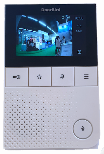

The A1101 is a stand-alone control station. Essentially, the DoorBird app on custom hardware. It was announced in France. But, for some odd reason, nowhere else.
