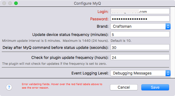

It looks like it won't let me save the change to Debugging Messages.
Oct 22, 2018, 10:48:19 AM
MyQ Debug validatePrefsConfigUi called
MyQ Debug logLevel = 10
MyQ Error myqLogin failure, JSON Decode Error
I've check my login info with the app and it's correct. Reentered it into the plugin config with the same result. I was looking for the log file incase it was showing up. Went to /Library/Application Support/Perceptive Automation/Indigo 7/Logs and there is no folder for MyQ. I suspect a folder isn't formed until debug is successfully saved. Here is a screen shot of the config window.

Re: JSON Decode Error
What plugin version is this?
The login/password fields are being highlighted because the plugin is unable to login to the MyQ servers with the given data. If this is something that just started happening, then it's possible that MyQ changed the login process. The plugin uses undocumented API calls so there's no warning if they do that.
