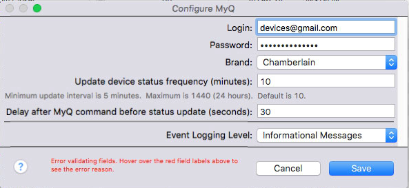

Hello,
I just tried to install your plugin 7.2.0 and I'm getting this error "Error validating fields. Hover over the red field labels above to see error reason"
Problem is nothing is red.
Screenshot 2018-10-20 06.03.51.png (137.72 KiB) Viewed 2728 times
I checked my login information and it's correct.
This is the error in the Event Log
Oct 20, 2018, 6:05:55 AM
   MyQ Debug                       logLevel = 10
   MyQ Error                       Error in plugin execution UiValidate:
  File "plugin.py", line 175, in validatePrefsConfigUi
KeyError: key updateFrequency not found in dict

Just installed 7.1.10 and it works great.
Edmond
Posts: 7823
Re: Error on new install
7.1.10 is the latest released version. 7.2.0 is in-development and is not an official release. The plugin store is pointing to 7.1.10. How did you download 7.2.0?
dnomode
Posts: 363
Joined: Sat Apr 12, 2008 11:48 pm
Location: North Georgia
Post by dnomode »
I got it from your GitHub page. I figured that was the problem.
Edmond
Posts: 7823
dnomode wrote:I got it from your GitHub page. I figured that was the problem.
Edmond
Ah. Getting it directly from GitHub is ok if you get it from the releases page. But the current commit is not necessarily usable.
