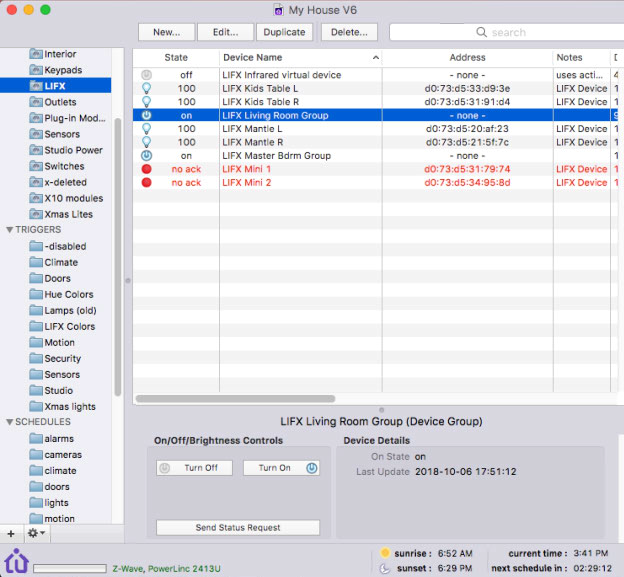

I created a device group of more than one LIFX bulb. I was surprised to find that the device group, in spite of only containing like devices, did not inherit any of the controls a singular device has available in the devices panel when selected in indigo. I realize a device group could include disparate devices with controls not common to each other, but I suppose I expected some sort of trapping there for like device types and the basic controls being passed thru and available to the group (such as dimming, choosing a color, etc).
Is that something the third party has to make happen? Or is that something the device group structure itself within Indigo isn't capable of?

Also this is kind of a general question but maybe it interests you depending on how indigo works under the hood:

I think the Indigo Device Groups just support On and Off?

@autolog is correct: a Device Group is inherently an on/off device though there are some special considerations made for devices in the group that also dim.
