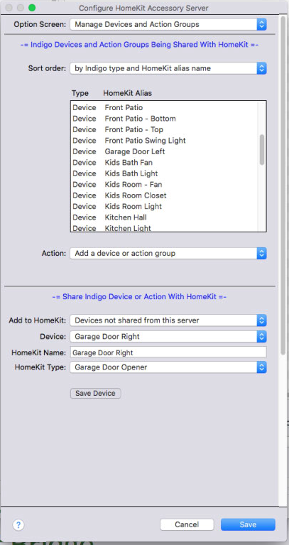

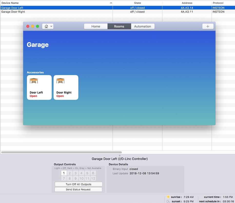

Mine also shows Open when the garage is closed. The invert switch is not available on mine. What am I missing?
Thanks for the help.

Re: Front Door Lock and Garage Door
The only time 'Invert' is available is if the device you are referencing has an On and Off state. Your 'Garage Door Right' doesn't have an On and Off state so that's why invert doesn't show. Choose a light switch, as an example, and you'll see Invert show up.
That being said, what kind of garage door opener is it? Out of the box it should support most of the standard ones but if you have one that isn't as widely used you may have to create a virtual device for it so you can get On and Off.
So anyone have an idea on how to make this work correctly using the Insteon I/O Link? The Apple Home App still thinks the garage is open when its closed.
Thanks for the help
Edmond

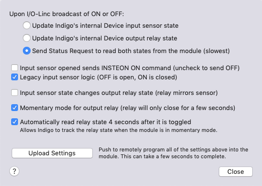

Edmond, I still have to work on the Homekit part, but to get the Indigo part correct, but here is what I did so far for Indigo settings:
1. Select the I/O Linc and click the Edit... button at the top of the Indigo interface.
2. In the Edit window, Select "Edit Device Settings..."
Use the setting in the attached screen shot. Make sure you hit the "Upload Settings" after changing them.
Update: I just checked my HomeKit and the status of the door sensor is matching Indigo.
- Screen Shot 2019-01-10 at 8.38.04 PM.png (68.18 KiB) Viewed 3800 times
That worked.Use the setting in the attached screen shot. Make sure you hit the "Upload Settings" after changing them
Edmond
