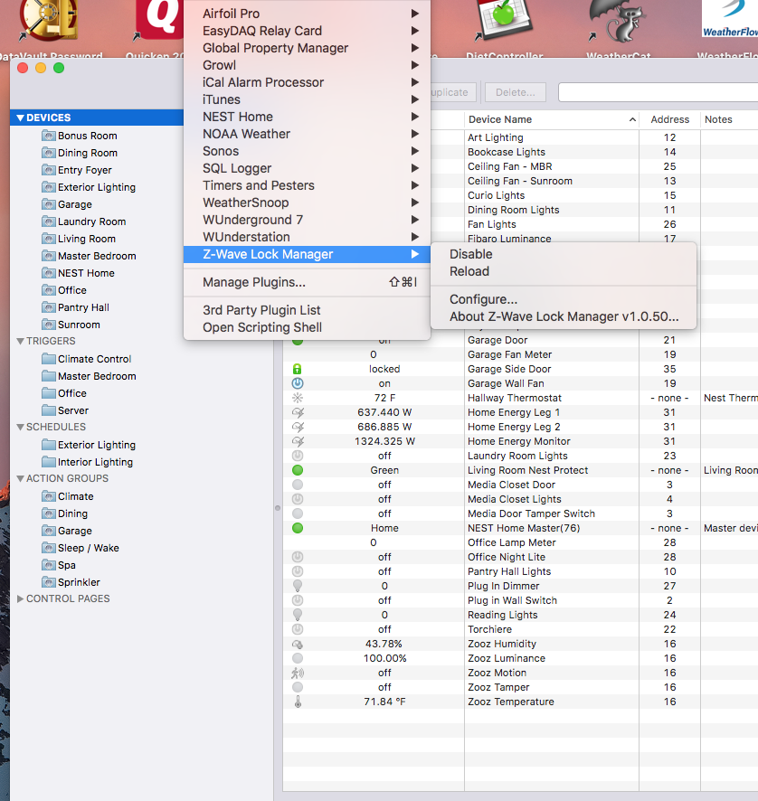

Just downloaded and installed the lock manager plugin. Seems to have went ok as I got no messages to the contrary. Where does Lock Manager show up? I'm attaching a screenshot showing it in the plugins dropdown. there isn't an option to create a device and add a lock, etc. I have the latest version of Indigo 7, just purchased license last week.

Never mind...I was missing something!

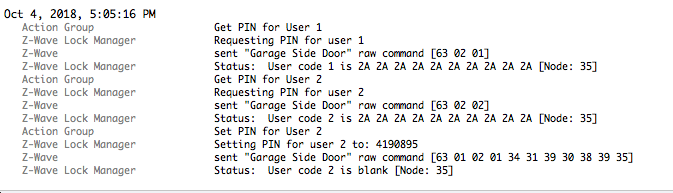

Revisiting the Lock Manager...when I try and retrieve or set PINS I get the following:
Am I doing something wrong? The process seems simple enough...

2A 2A 2A 2A 2A 2A 2A 2A is ******** - in other words your lock doesn't support retrieving of PINs.
Not sure about the "blank" message off top of my head, but probably related - have you tried using the code you set?
Peter

Just tried the PIN I set, it works fine...appears I can set codes but can’t retrieve them :)
