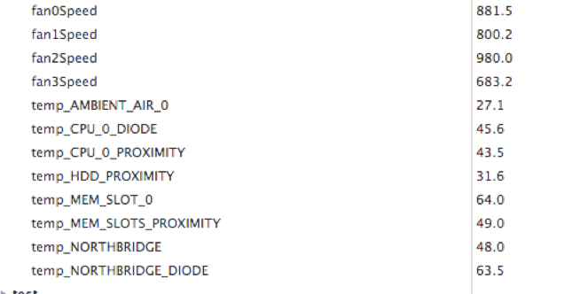

and the indigo code to import into variables:
import subprocess
### change the path to the path where the executable is located
data = (subprocess.Popen("/users/karlwachs/indigo//osx-temp-fan",shell=True,stdout=subprocess.PIPE).communicate()[0].strip("\n")).split("\n")
tUnit ="C"
t_format = "%.1f"
for line in data:
    ll = line.split(":")
    if len(ll) < 2: continue
    if  ll[0].find("temp") > -1:
        t = float(ll[1])
        if t < 0: continue
        if tUnit == "F":
            t = t*9./5/+32
        try:      indigo.variables[ll[0]]
        except:   indigo.variable.create(ll[0])
        indigo.variable.updateValue(ll[0], t_format%t)
        indigo.variable.updateValue(ll[0], ll[1])
It will automatically create the temp and fan variables. values of -99 mean: no info, no variable will be created.
This code assumes the executable is in ~/indigo/
It was tested under El Capitan and High Sierra
if the executable "osx-temp-fan" is not "executable", right click on file info and add "execute" to the rights.
