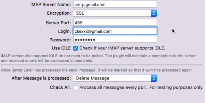

The Better Email device state shows, "Success" but when I execute a send email I get these errors.
Better Email Error              Better Email Server: Error connecting to IMAP server: IMAP4 protocol error: socket error: <type 'exceptions.IOError'> - Too many read 0
   Better Email Error              exception in deviceStartComm(Better Email Server): IMAP4 protocol error: socket error: <type 'exceptions.IOError'> - Too many read 0

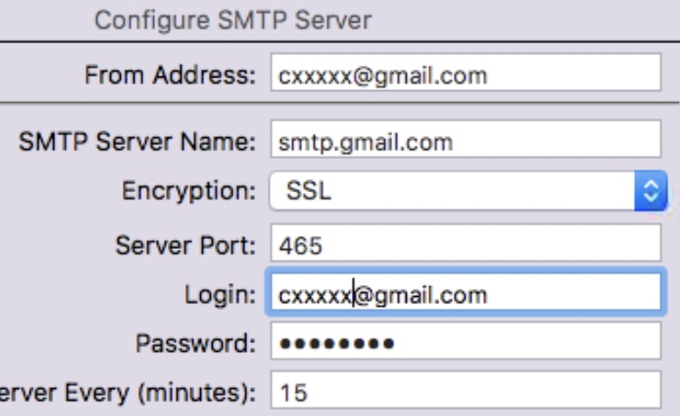

From what I can gather I believe these email settings are supposed to work for a gmail account?
Carl
Re: Email Attachments?
IMAP is for receiving mail. To send mail you need to create an SMTP device.
Create the device. Fill in the fields like you did for the IMAP device.

Post by ckeyes888 »
Been trying that with no luck. I have a number of email accounts and can’t make any of them work.
