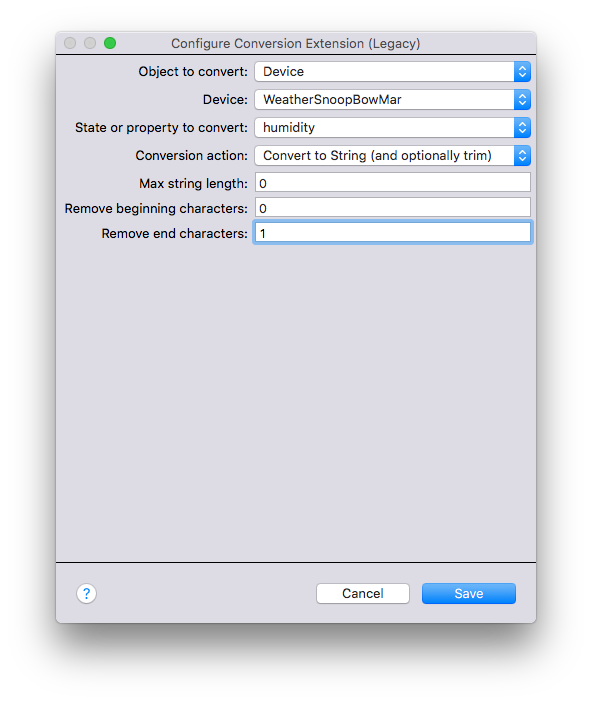

As Howard says, the % is generally a UI value, but you can still do this with DE by using the 'Convert to String' option and chopping off the last character. You can also use the String to Number conversion to get what you are looking for - which could be better since it will allow you to convert to an integer (no decimals) or a float (decimals) and you can decide how many decimal places you want it to have.

The device state shows the % sign when using the sensorValue (UI Value), but not when just using sensorValue.
Seems to be working fine.

ckeyes888 wrote:The device state shows the % sign when using the sensorValue (UI Value), but not when just using sensorValue.
Carl
Yup, that's exactly what you should be seeing.
