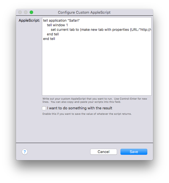

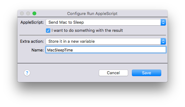

Just posted Beta 2 because of something kind of cool - full AppleScript editor ready to build-and-run:
AppleScript Editor and Action
More enhancements to the editor are planned, pretty basic at the moment but that won't last long!

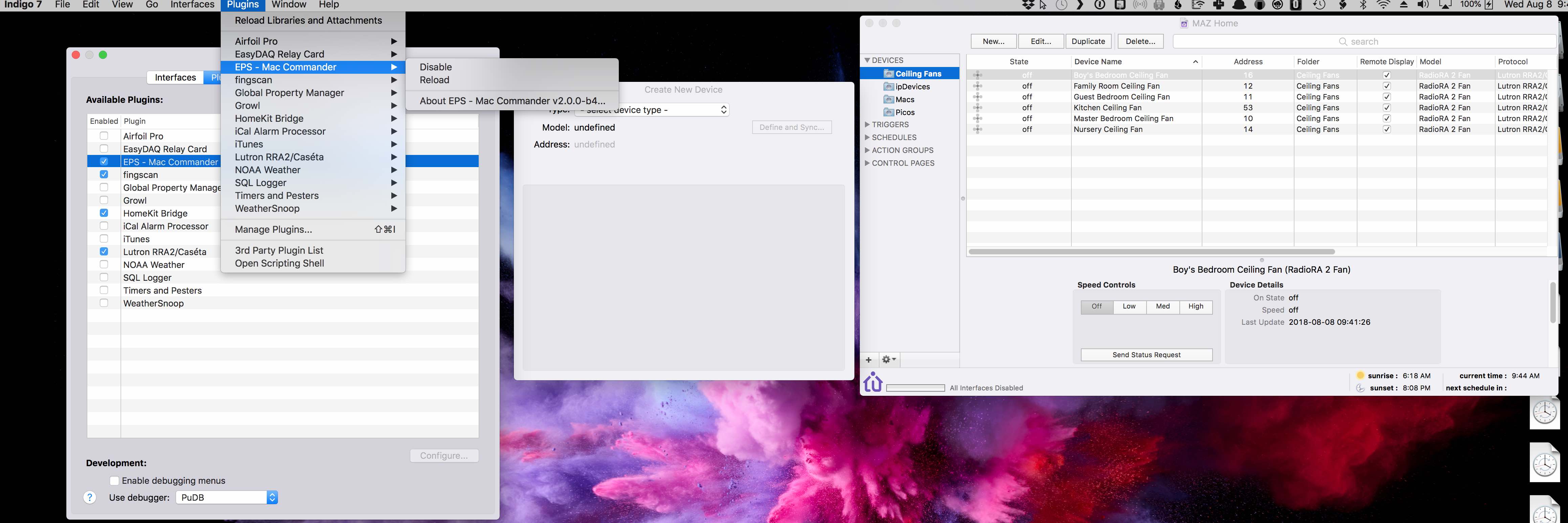

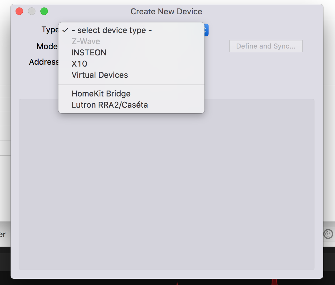

Super confused as to how to get going with Mac Commander 2... In v1 I was able to add a Mac from my local network as a Device but now there's no option to do that anymore...?
I have the new v2 beta plug-in installed (and of course have my local network Mac that I want to control all set up) but when I go to add it as a device in Indigo 7 there's no "Mac Commander" option like there used to be in v1 (see attached screenshot).
Seems like I'm missing something very obvious. :?
Screen Shot 2018-08-07 at 10.31.48 PM.png (112.72 KiB) Viewed 19652 times
Colorado4Wheeler
Posts: 2794
Location: Colorado
Re: Mac Commander 2 Open Beta
Post by Colorado4Wheeler »
It looks to me that Mac Commander isn't installed or is disabled. There would definitely be an option there if it was installed and enabled.

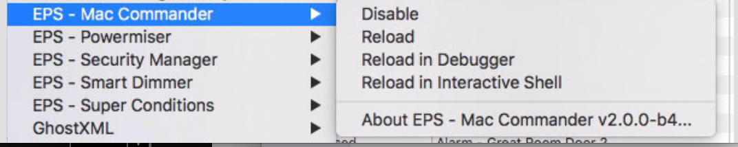

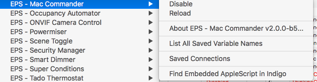

That doesn't make sense on several levels. At the very least your menu, if the plugin were fully enabled, should have more options. Even though mine is B5 that's only because I increment the beta number on my own system after release, it's still the same code as B4.
Screen Shot 2018-08-08 at 11.55.43 AM.png (58.32 KiB) Viewed 19593 times
The only other way for me to test would be to wipe out my development setup so I can install Mac Commander from scratch but I recently did that for another reason and the plugin is there and shows all the options. Anything in the log?
