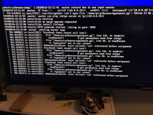

I had posted an earlier question regarding a new project I am working on to automate my dust collection in my woodshop. It was a pretty dense post and it didn't get much traction, so I decided to dive in and see if I can figure out a good path forward. I am at the point of needing to use some of the custom sensors/programs that I think is the point of the mysensors.py, myprogram.py, and myoutput.py. After reading many many posts and google searching on those keywords, I am not fully understanding how the pieces fit together for these features. In addition, when I enable the mysensors.py by renaming the file on the rPI I am getting the error below.
So my ask would is....Can you provide a more detailed explanation of each of these three custom code devices and actually how to use them? I am not able to piece together from the sparse posts on the subject. For instance, do I edit a file on the MAC indigo server or do I edit a file on the rPI? On the rPI I am seeing a file named myprogram.py that already exists, however, in the same pibeacon directory on the rPI I see a file named "RenameMeTo_myprogram.py". Am I supposed to overwrite the existing file? I am also seeing a syntax error on the mysensors.py file on line 12. It is importing the sys namespace and the next line of code is calling isys.
