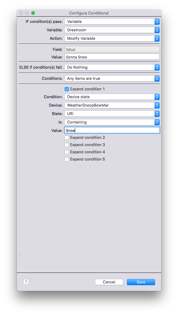

First, can you post a screenshot of your UI so we can see exactly what you have there? That would help me understand better why it may or may not be happening.
Second, you can try my Super Conditions to see if it does a better job for you, it can handle what you are asking (screenshot is of one I just did).

If you are testing the trigger by clicking on the "Execute Actions Now" button then that won't test your conditions - it will just execute the actions without evaluating the conditions.
