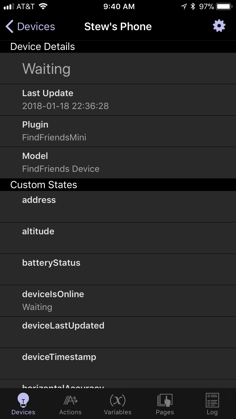

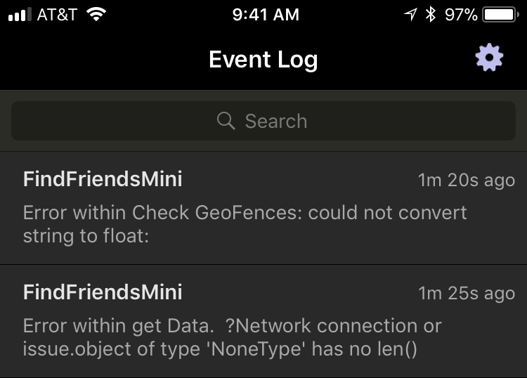

stewkenly
Posts: 42
Joined: Mon Dec 28, 2015 1:57 pm
Location: Austin, TX
Re: FindFriendsMini a new iCloud FindmyFriends Plugin
Post by stewkenly »
I have created a separate icloud account and the plugin appears to be able to log in. I say that because I get a notification from Icloud about a new login. I see a couple of errors that appear to be preventing an update.
The device "Stew's Phone" says "waiting" and doesn't update.
Thanks for the help!
