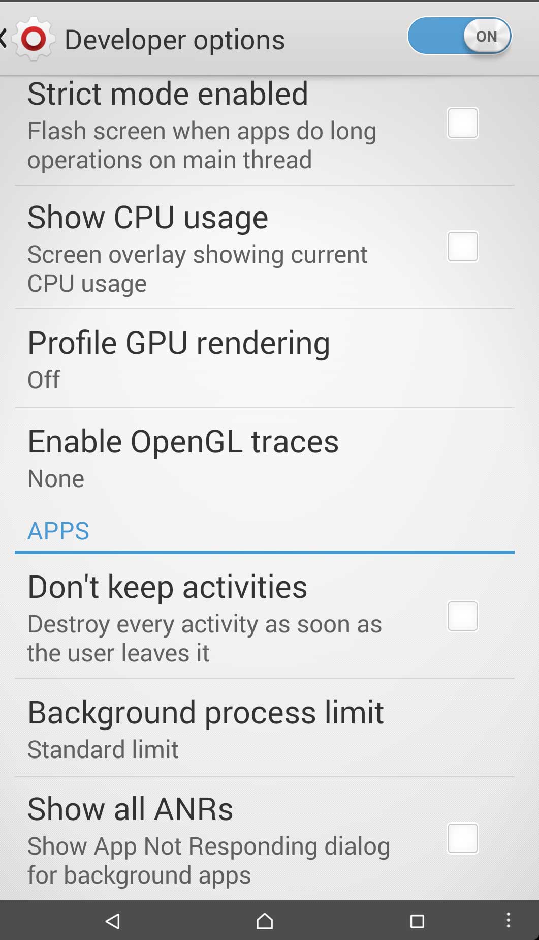

Another thing to check - If you have enabled Developer Options in settings, there is a switch that prevents apps from running in the background. I don't remember how it's labeled, but it's pretty apparent by the name. It's off by default, but make sure you didn't inadvertently turn that on as it will create the scenario you mention above. I think I remember seeing other options to tune background processes somewhat, you you might check those out too. I don't have a Fire device with me at the moment so my apologies for not being able to point you directly to the switch.

Here's an image of what Terry said
Setup--> Developer Options, than scroll toward the bottom
If you dont see the Developer Options than go to "About Phone" and click on the "Build Number" 7 times.
