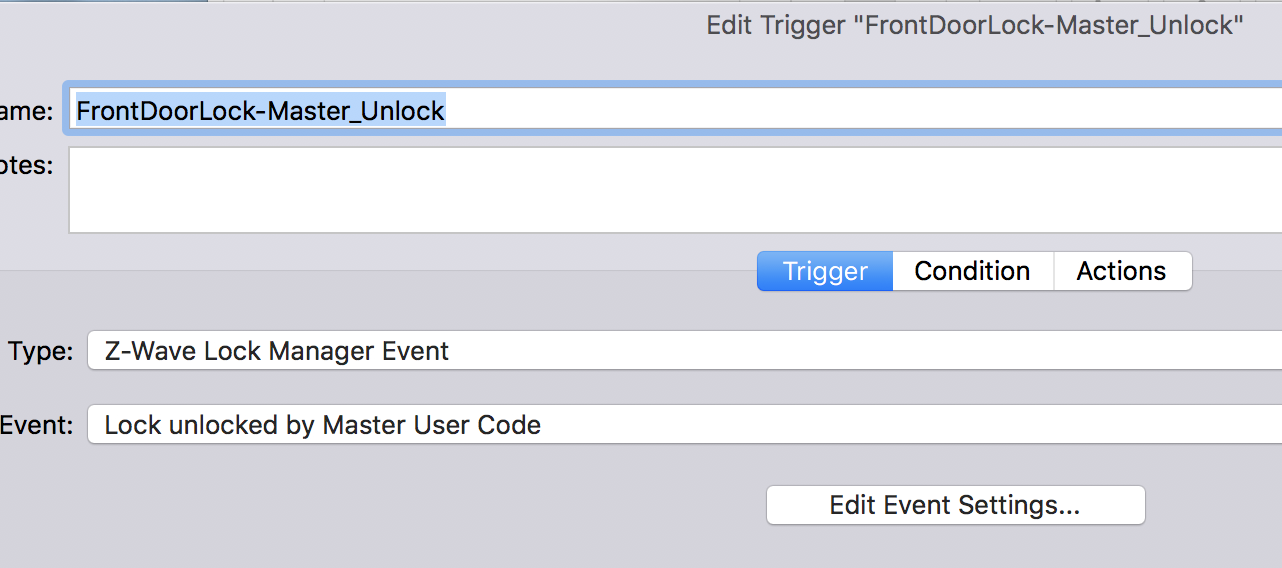

Re: Unable to select user 251
I have similar issue, I can go as far as user id 250, so I have a trigger set to trigger in the event if "Lock is unlocked by Master User Code".
Z-Wave received "Front Door Lock" status update unlocked (via keypad)
Z-Wave Lock Manager Status: User 251 unlocked door [Node: 33]
Z-Wave Lock Manager Error Error in plugin execution ReceivedBroadcast:
File "plugin.py", line 312, in zwaveCommandReceived
File "plugin.py", line 603, in triggerEvent
KeyError: key userNo not found in dict
- Screen Shot 2017-10-30 at 7.33.42 PM.png (132.17 KiB) Viewed 5597 times
