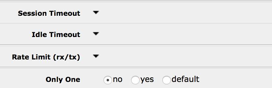

I use a Mikrotik Router.
The VPN profile allow setting session timeout, idle time out as well as number of concurrent sessions.
Check your router to see if it has similar features.

That would have been great, but alas......the Orbi doesn't have that level of sophistication when it comes to the VPN server. At least not yet. There are some things that I really like about the Orbi and other things that I hate. For the price point you would think it would have these types of features.
