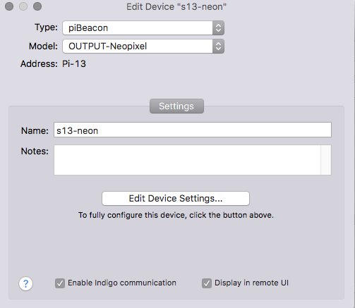

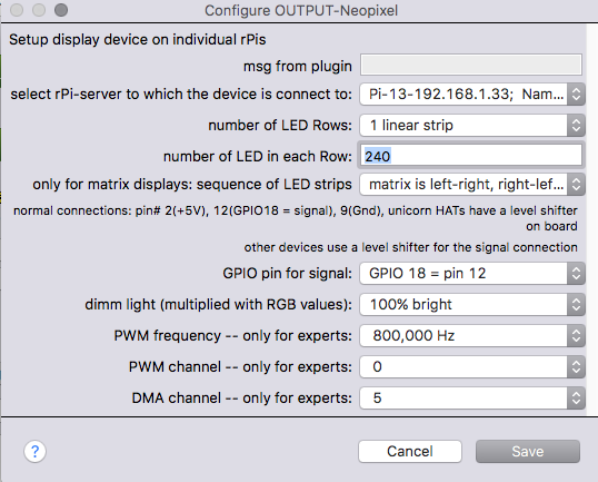

setup:

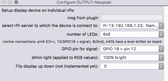

1. create a pibecon/ neopixel device:
Screen Shot 2017-04-09 at 17.21.55.png (39.73 KiB) Viewed 13532 times
Screen Shot 2017-04-09 at 17.22.11.png (53.56 KiB) Viewed 13532 times

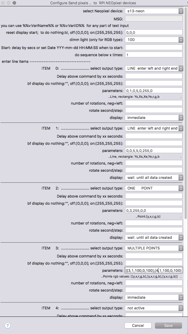

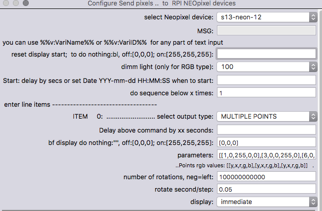

2. create an action
Screen Shot 2017-04-09 at 17.24.06.png (204.61 KiB) Viewed 13532 times
then you can switch the lines / pixel on / off through this action
you can also create a script:
plug.executeAction("Neopixel" ,	props ={
   "outputDev":"22876764"
  ,"device":"OUTPUT-neopixel"
  ,"restoreAfterBoot":False
  ,"intensity":100
  ,"repeat":""
  ,"resetInitial":"[0, 0, 0]"
  ,"command":'['+
      '{"rotate": "", "delayStart": "", "rotateSeconds": "", "position": [2, 3, 5, 5, 100,0,55], "type": "line", "display": "immediate"}'+
     ',{"rotate": "", "delayStart": "", "rotateSeconds": "", "position": [4, 6, 7, 7, 55, 0, 100], "type": "rectangle", "display": "immediate"}]'
and run that.

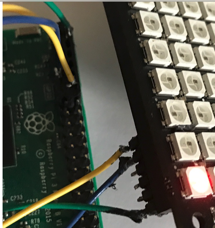

2. pomoroni @ https://learn.pimoroni.com/tutorial/uni ... nicorn-hat 8x8 and 4x8 hats that come ready to plug into the 40 pn header of the RPI, no wiring needed, but you need a level shifter (3.3 <-> 5V for the signal)
Screen Shot 2017-04-09 at 18.17.39.png (922.81 KiB) Viewed 13517 times

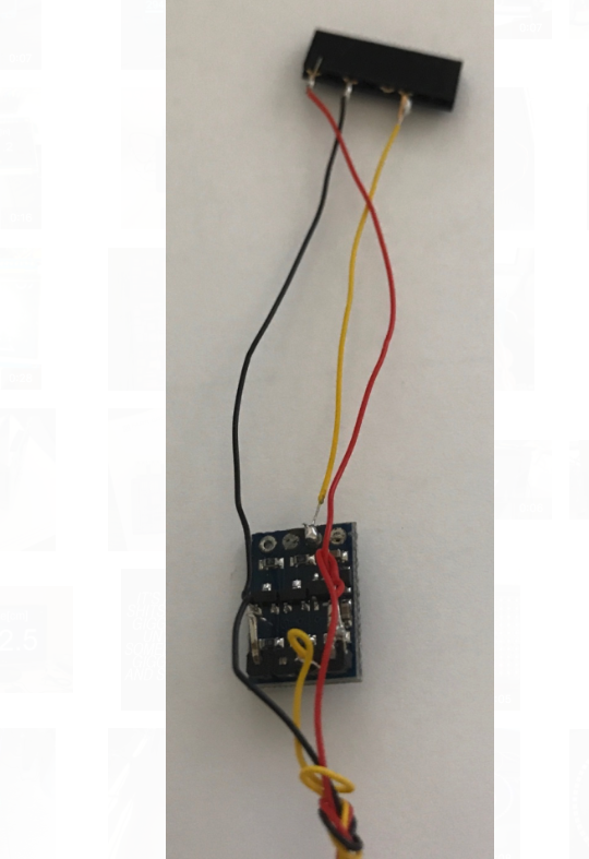

yellow = signal cable pin# 12 (GPIO18); green = V+5V pin#2; blue =GND = pin# 9

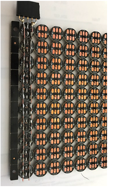

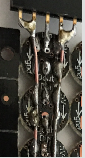

3. cheap ones e.g. : Kuman 100pcs WS2812B 5050 Addressable SMD . They go for $18 for 100 =$0.18 a piece. They are single pieces, still on the boards as the come out of the assembly. You need to solder them together. Not very complicated. connect V+ and ground all the way through and the signal out goes to signal in on the next LED (middle wire)
Screen Shot 2017-04-09 at 17.09.28.png (269.49 KiB) Viewed 13537 times
in total like this:
Screen Shot 2017-04-09 at 17.05.28.png (513.06 KiB) Viewed 13537 times

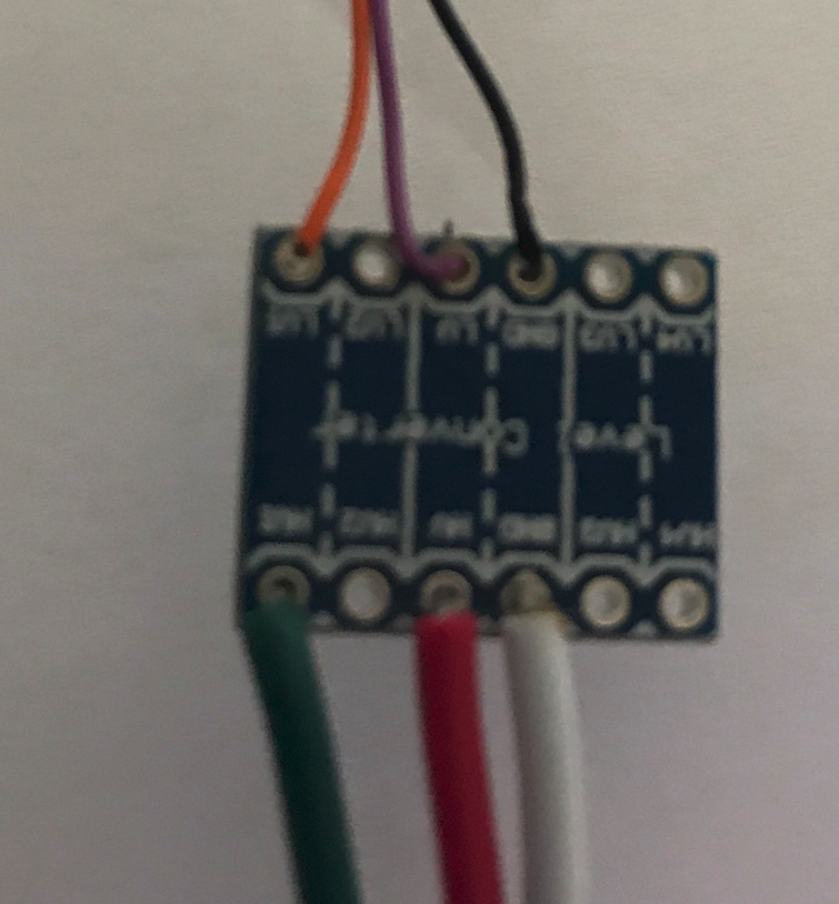

and you need a level shifter
4. Mongunkit. cheapest. they need a 470 ohm resistor in the data in cable after the level shifter, but quality seems to be good
level shifter e.g.: https://www.amazon.com/I2C-Logic-Level- ... 5978&sr=8-10&keywords=level+shifter+3.3v+to+5v
Screen Shot 2017-04-09 at 19.03.13.png (104.06 KiB) Viewed 13513 times
depending on your level shifter you might not need the +3.3V,... only 3 cables: V+5, and and signal.
And ground can be picked up from any ground pin on the RPI. You could just use the even pin row V+5(pin2,4) and ground(pin6) and signal (pin12=GPIO18)

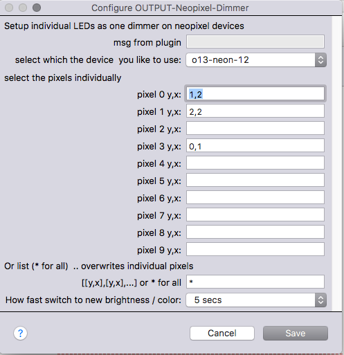

neo pixel indigo RGB dimmer device
First setup a neo-pixel device where you configure the format (e.g. 8x8 or 1x10 LEDs), which pins , which RPI etc.
Second setup one or more pibeacon/ neopixel- dimmer devices. There you specify which of the LEDs of the just defined (firs step) neo-pixel device should be part of THIS dimmer device.
You could select all, or 1, or 3 of the LEDs. So you could for a 1x10 neo-pixel device have up to 10 dimmer devices, one for each LED -- or just one for all LEDs
Screen Shot 2017-04-13 at 14.11.18.png (64.54 KiB) Viewed 13401 times
. In the example:
The pin numbering format is y,x with y,x = 0,..n ; n=. # of pixels in row, # positions in row, so for a 1x10 that would be y=0 and x=0..9, for a 8x8 y=0..7 x=0..7
The * is a shor tcut for all LED, This field will overwrite the individual pins above.
to enter a list use e.g.
[[0,0],[3,2],[2,5],[7,7]] or a referencee to a variable with v%%:variName%% or v%%:variID%% and maintain the list there .
without the *, the pins
y=1,x=2
y=2,x=2
y=0,x=1
would be used

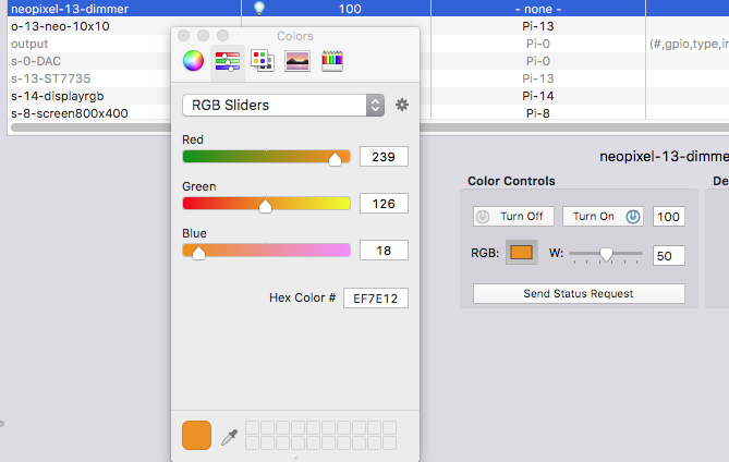

Then you can use standard indigo dimmer commands in the UI or scripts to set the LED RGW/W levels.
Screen Shot 2017-04-12 at 18.09.42.png (58.46 KiB) Viewed 13467 times

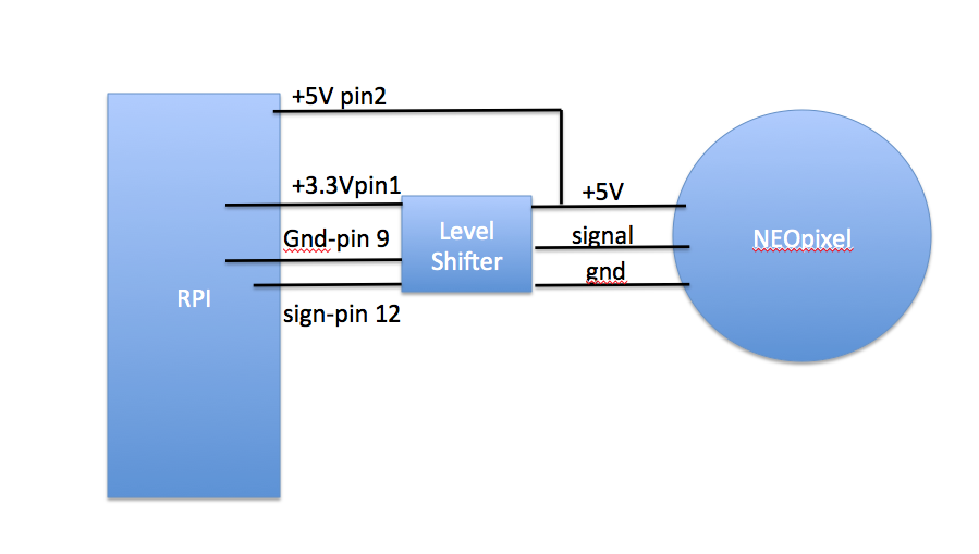

how to connect:
for most NEOpixel devices:
connect the NEO-pixel rings through a level shifter (3.3--5 V) to your RPI
V+5V pin2 , -- to V+5 on shifter , to V+ on NEO-pixel device (if current is < 0.5Amps)
GND- pin 6, -- to shifter GND to gnd on NEO-pixel device
Signal = pin 12 -- level shifter -- D-IN on NEO-pixel device
red =V+5, black = ground, yellow = signal

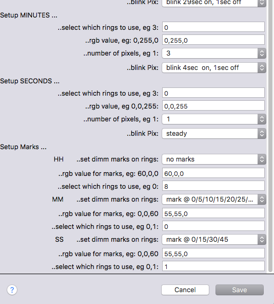

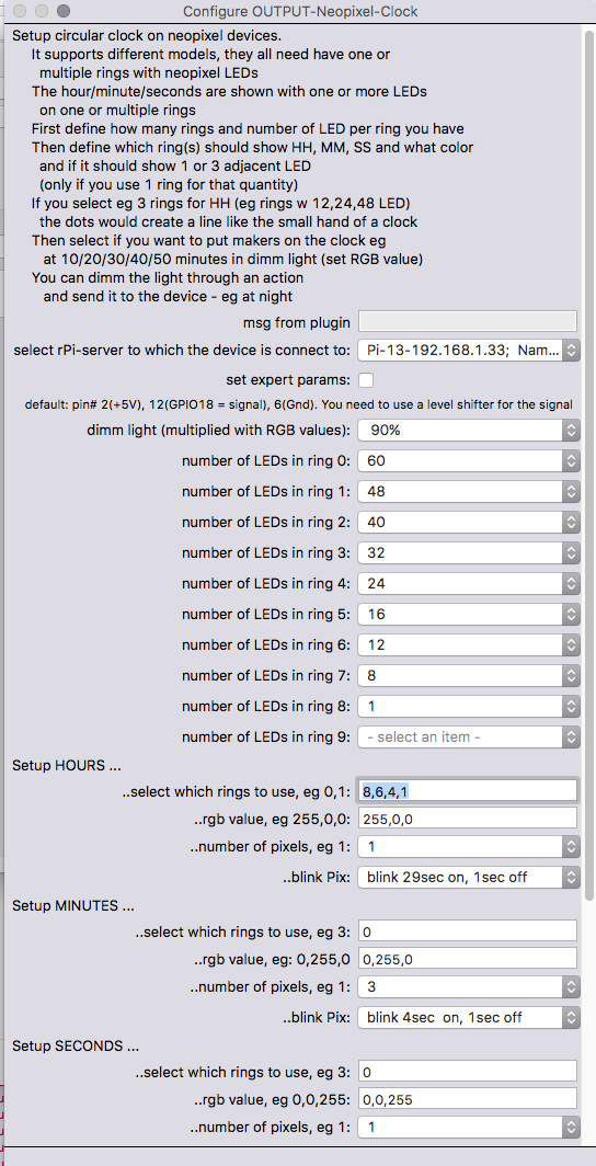

NEO-PIXEL Clock
create an indigo device pibeacon/ neo-pixel-clock and set the following parameters:
V+5V pin2 , -- to V+5 on shifter , to V+ on NEO-pixel devcie
Signal = pin 12 -- level shifter -- D-IN on NEO-pixel device. If the neo pixel device does NOT have a 300-500 Ohm input resistor you need to add one between the level shifter and the neopixel
The Adafruit device all have it on board,50% of the china direct import / no name do NOT have it.

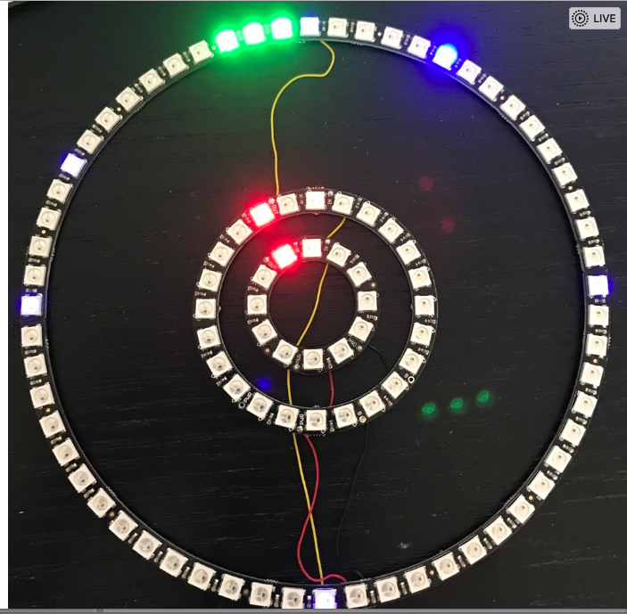

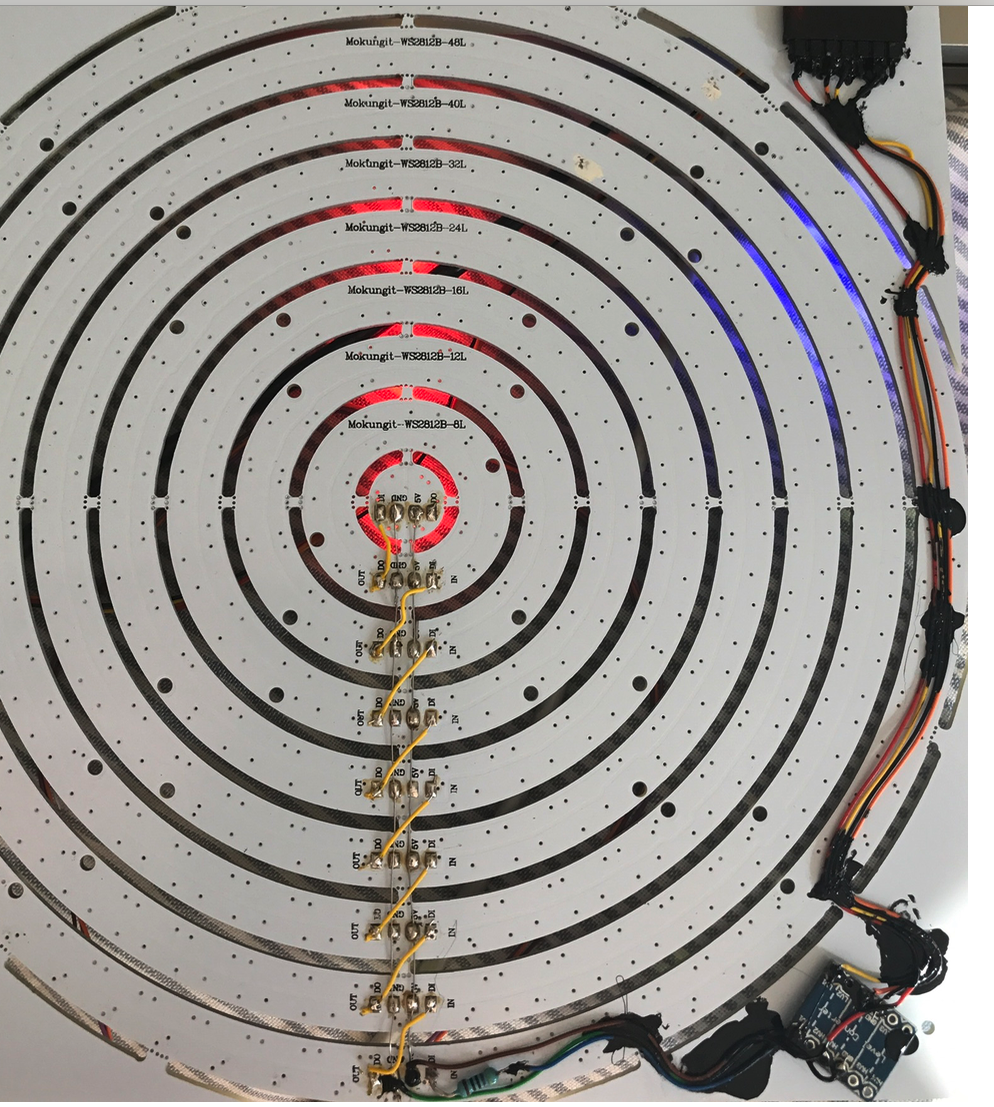

with 3 rings you can get this:
Screen Shot 2017-06-14 at 12.08.43.png (838.88 KiB) Viewed 13426 times

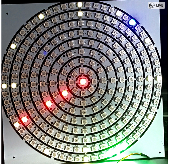

11am 58 minutes and6 seconds, make at 0/15/30/45 secs (dim blue) and dim red on the HH rings at 0 (not well visible in the pic)
with the following config and a 9 ring device http://www.ebay.com/itm/1-241-Bits-WS28 ... 2749.l2649
Screen Shot 2017-06-20 at 19.59.52.png (212.57 KiB) Viewed 13231 times
Screen Shot 2017-06-20 at 20.00.05.png (100.47 KiB) Viewed 13231 times
with 9 rings(1/8/12/16/24/..48/60 rings you get this:
Screen Shot 2017-06-20 at 20.28.41.png (804.11 KiB) Viewed 13229 times
this is how the cabling looks like:
Screen Shot 2017-06-20 at 20.05.36.png (1.97 MiB) Viewed 13231 times
4 cables from RPI to level shifter(and, signal, +5V,+3.3V); 3 from level shifter to device (signal through a 470 Ohm resistor) The cable do not have to be big as not many LEDs are lit.
You can select 1/3 pixel to show per HH/MM/SS and show HH/MM/SS one several rings . Then each of the pixels can be stead or blink once per 1,2,5,10,15,30,60 seconds. e.g. at SS=0 or 10,20,30,.. or 0/15/30/45 seconds etc .

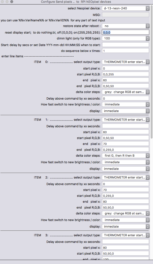

NEO pixel thermometer
1. define a NEO pixel device in pibeacon:
Screen Shot 2017-06-14 at 12.17.32.png (88.63 KiB) Viewed 13425 times

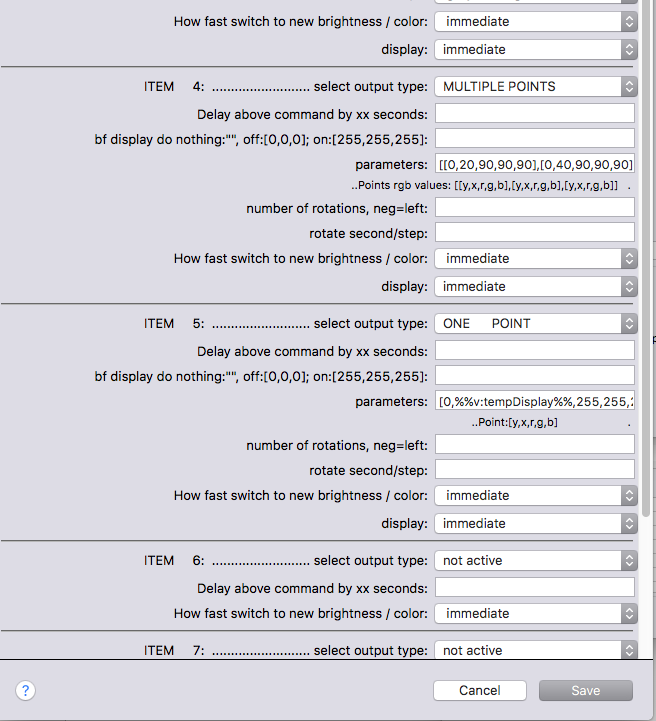

2. creta an action / pibeacon/ thermometer
Screen Shot 2017-06-14 at 12.16.41.png (198.99 KiB) Viewed 13425 times
Screen Shot 2017-06-14 at 12.16.52.png (128.58 KiB) Viewed 13425 times
3.then you get:
Screen Shot 2017-06-14 at 12.15.47.png (207.03 KiB) Viewed 13425 times
you need to create and indigo variable "tempDisplay" hat should contain the current temp in F (for this setup)
then trigger the action when the variable changes and you will have a very large thermometer going from blue (=0 Fº .. green 70F .. red 120F) and a white dot where the current temp is
and dim white dots at 20/40/60/80/100 F
and also here connect to RPI V+5, signal through level shifter and GND as described above

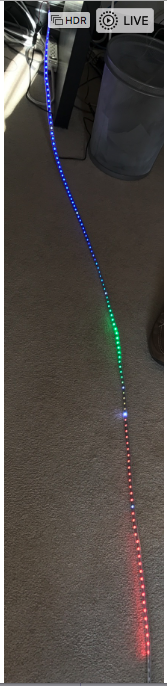

tested neo pixels devices:
they must state WS2812B 5050 RGB 5Volt
the 12V have 3 RED 3 GREEN and 3RED LED insures, so you can not address single LED's
They might work but I don't know how the level converter works with them
1. PI-HAT neo pixel, very good quality, they fit directly onto the Rip. they come in various forms, 2x8 .. 8x8
2. simple long strips, water proof or "naked" from 10 .. 240 (tested that one. you can get them from china for
300 for $9
http://www.ebay.com/itm/5m-300-LED-Flex ... bzmNlix8Aw
3. rectangles in all kinds of forms and shapes, some raw from the production line, not wired others prewired.
4. rings:
http://www.ebay.com/sch/i.html?_from=R4 ... s&_sacat=0 single rings to a whole set of rings with up to 60 LED in the outer ring ==> good for the clock
They all seem to work fine. it is a commodity and likely not worth paying for "quality"
