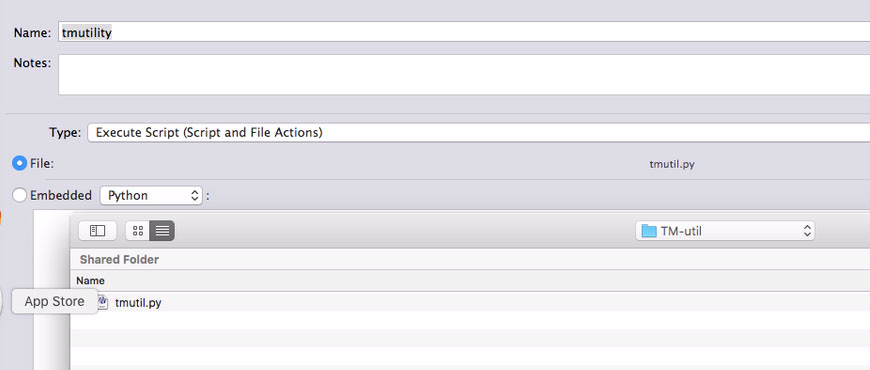

Re: check TimeMachine backup status
you can put this script into the action script window (embedded script) or save it to a file (e.g. ~ documents/tmUtil.py
Screen Shot 2017-05-13 at 17.42.33.png (79.11 KiB) Viewed 3032 times
) and call the script in the action setup.
this is useful if your system is busy and the script in the embedded version times out.
