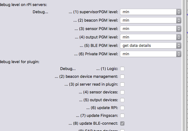

could you switch on BLEconnect debugging in config on the Mac and on the RPI., see screenshot. then do a "push config to the RPIs" in the plugin menu
on the RPI do:
ssh pi@....
cd pibeacon
tail -f /var/log/BLEconnect.log
and post
and on the Mac you then should see any message from the RPI that comes from BLE devices (you could switch on "send logging to file" -- in config - if there is too much info. The MAC beacon logfile is in ~/documents/pibeacon )
and post those
on the mac you should see:
and on the PRI:

- Screen Shot 2017-03-05 at 07.16.45.png (69.2 KiB) Viewed 3426 times
