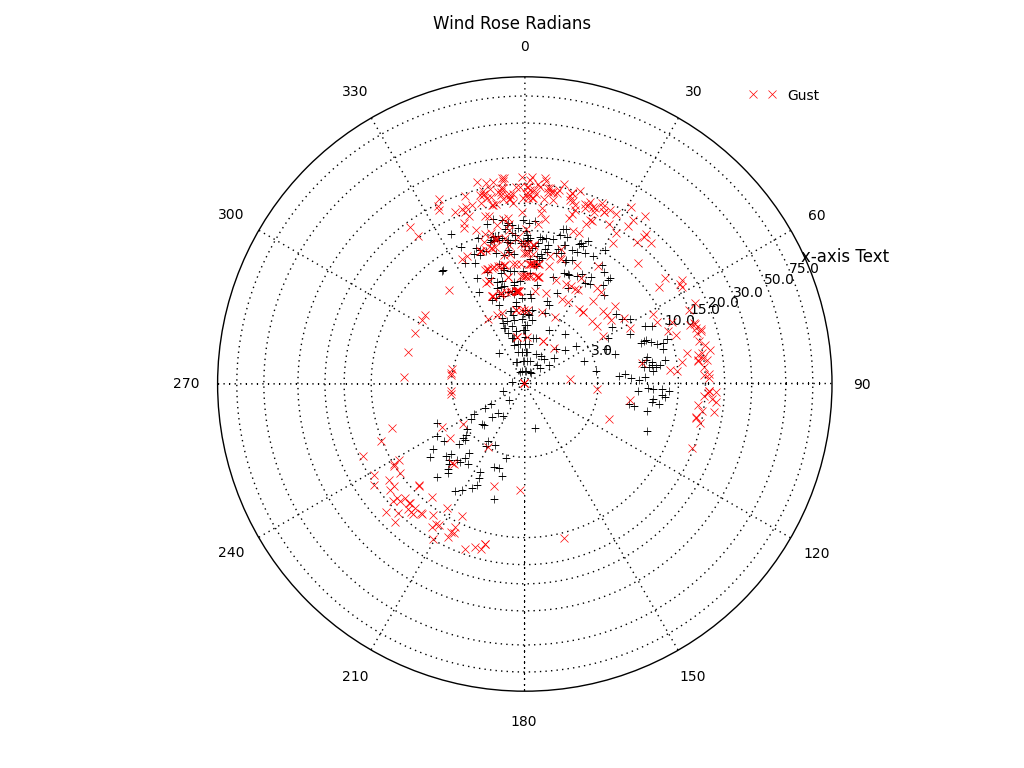

Correct; although we pulled cat5 from the server room to the breakfast nook where the console sits partly so we could look at all the data at a glance; however, we needed the connection and 4 port switch anyway because that's where we tie in the magicjack for the phone and hooked up a hardwire for the back door rPi rather than running it wireless. For me, the latency wasn't as big an issue as the fact that our satellite internet service drops out whenever heavy weather rolls in and WU underestimates the rainfall as a result if the storm occurs across the midnight reset. But once the data is in Indigo, you can do a whole lot of graphical stuff using Dave's and Karls plotting packages, for example a log based windrose:
