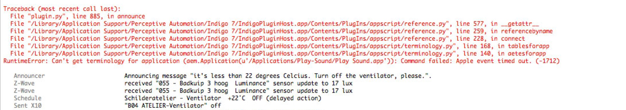

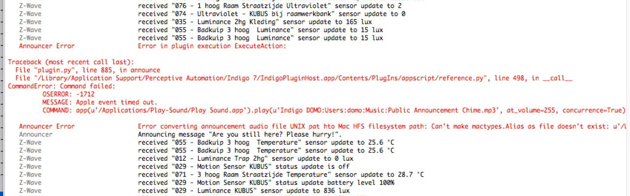

Hi Nathan,
Since I transfered Indigo from my Mac mini server running 10.6.8 to a brand new Mac Mini running 10.12.6 especially for Indigo 7 only I have had problems with Announcer. When the Mac mini has restarted Announcer works flawless. After a few days (most of the time 2 days) it stops working properly and I have to restart the computer again.
I get the following in the Indigo Event LOG:
(see attachments)
Thanks!
Mirko
(see attachments)
Thanks!
Mirko
- Announcer 2.jpg (280.19 KiB) Viewed 5260 times
- Announcer 1.jpg (341.11 KiB) Viewed 5260 times
Re: Announcer Usage questions
Hi Mirko.
Odd. The error seems to indicate that the audio file that's supposed to be created by Announcer then sent to the Play Sound application no longer exists. You might try repairing permissions on your drive using Disk Utility. I'll see what I can find on my end too.
Hi Nathan,
Thanks for looking into the matter.
I just ran the Disk Utility but in 10.12.6 the Disk Utility is different now. You can only 'run First Aid' and it will 'check the volume for errors. It will then repair the volume if necessary.'
It seemed all OK.
I also checked the path to the audio-files; it's OK
I checked in Announcer if something is wrong with the description of the path to the audio-files: it's OK
Everything seems in its place........
It seemed all OK.

This error came this morning. Maybe it helps......
Error (client) timeout waiting for plugin response from com.nathansheldon.indigoplugin.Announcer for request UiGetValues1
Error (client) timeout waiting for plugin response from com.nathansheldon.indigoplugin.Announcer for request CallPluginFunc
Error (client) runDialogForMenuAction() caught exception: NSInvalidArgumentException -- *** -[__NSPlaceholderDictionary initWithObjects:forKeys:count:]: attempt to insert nil object from objects[0]

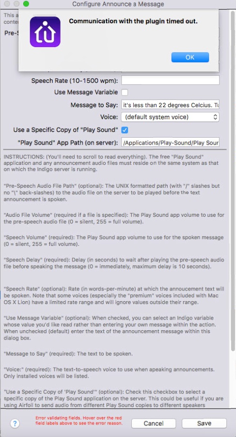

When I hit the 'SAVE'-button another time it went OK, but I had to restart the computer to have Announcer working again
