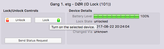

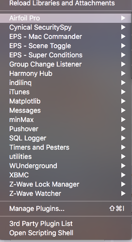

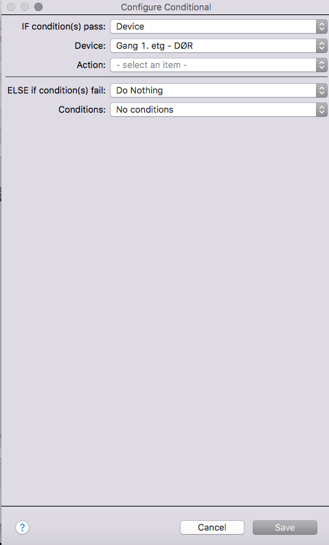

Its happen with every device that I have Æ,Ø,Å character in the device name.

Ahhh, now I understand. I'm not sure how I would take those into account but I'll see if I can think of anything.
