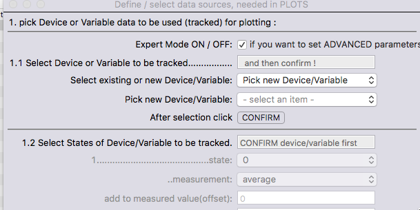

This morning I noticed I cannot use a variable as source for IndigoPlotD as only my devices are listed. While executing step 1 (selecting existing or new Device/Variable) only the devices show in the drop down.
Is there something I overlook here?

you should see something like this:
Screen Shot 2016-12-11 at 09.15.11.png (33.11 KiB) Viewed 7014 times
The list should contain Var-variableName and deviceNames.
The plugin preselects items that have contents that look like a number and True, up,On,ON,on, etc and de-selects "weather is fine" or "1.2 xx 56"
If there is NO Var-xxxx in the list you might not have a variable that looks like a number or we have a bug..

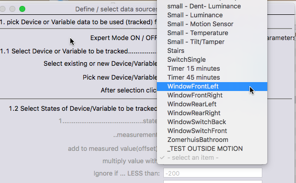

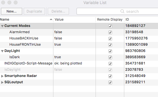

I added two images:
- VariableList
- Source Selection Dropdown
As you notice, the variable has a true/false value, and the name seems ordinary to me (HouseFrontInUse) :)
Hope these additional details clarify this issue :idea:

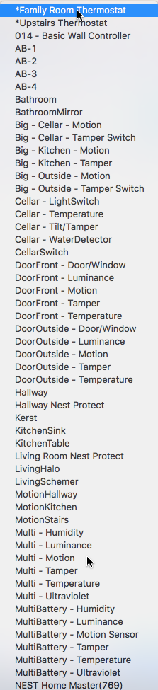

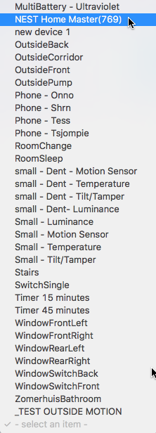

Also added a more complete list as shown in the dropdown.
[EDIT]
Second image, now complete dropdown is shown
Re: IndigoPlotD Variable not available to set as source
There is no Var-xxx above *Family room?
and which version are you using?

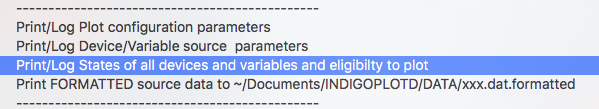

and copied you do :
Screen Shot 2016-12-11 at 11.12.22.png (49.23 KiB) Viewed 6974 times
that will produce a LOOOONG list in the log file and it should start with:
  INDIGOplotD                     pending indigoCommands: ['PrintDevStates']
   INDIGOplotD                     variables -------------------------  Value                                   used as
   id: 1235558255                                                  abc: 0                                  ; ==> 0.0

it will show which variables and device /states it thinks are numbers
and I see the issue: true is not accepted!!!
I will fix that
