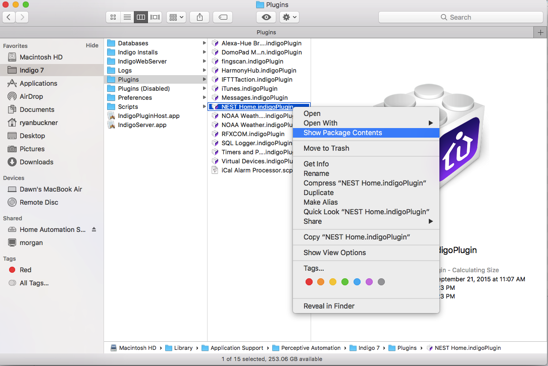

ryanbuckner
Posts: 1409
Location: Northern Virginia
Re: Latest Version - 2.0.41 for NEST Home, NEST Home 2 & 3
Post by ryanbuckner »
jbinder wrote:Pardon my ignorance. Where is actions xml located?
1. Disable the plugin
2. Navigate to Indigo 7 > Plugins (Disabled) > Nest Home *
3. Right Click on Nest Home and click on Show Package Contents
4) Edit the Actions.xml file as noted in the response above by Woetjes
* Note that I took the screenshot after I re-enabled the plugin so the folder is different
