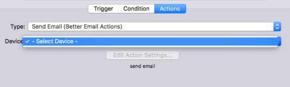

Hello.
I have an problem.
I cant se any devices in the list.
Better Email Checking for updates...

- plugg in.png (42.61 KiB) Viewed 9574 times
- Posts: 7830
Re: Better Email Q&A
Did you create one? To send email you need to create an SMTP Device.
