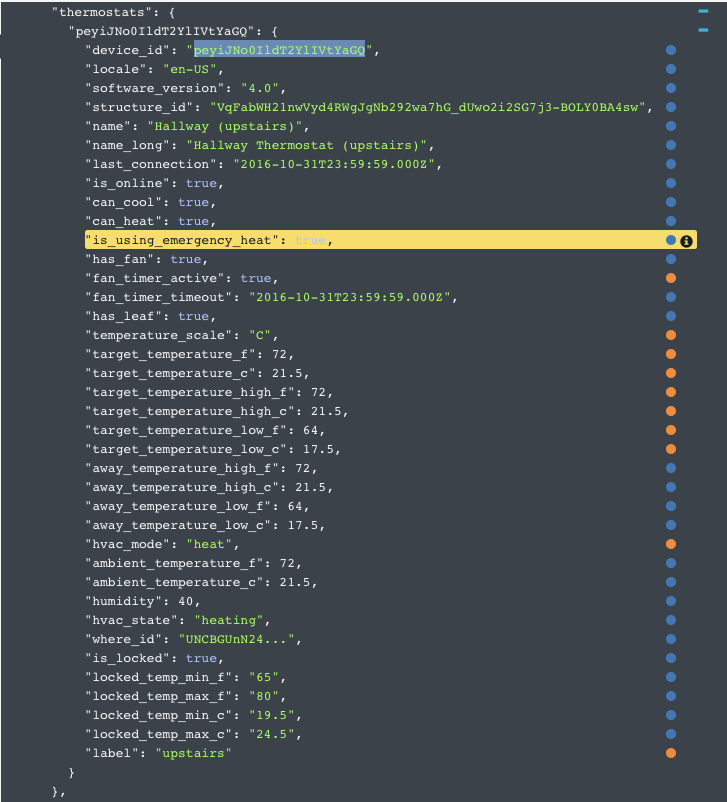

It's a good question. The NEST API doesn't actually provide a temperature setting for the hot water on it's own nor does it seem to switch it on or off independently of the heating. At the normal boiler switch the hot water is continuously on and is controlled by the boiler thermostat (or immersion thermostat). It is only the heating/cooling that is managed through the NEST from what I can tell.Scotfree wrote:Can you please tell me how to find the HW on/off variable ? None of the states displayed seem to be assigned to the HW relay being switched on and off.
Thanks.
The NEST Home plugin follows the same structure as the official NEST API from Google. I've provided the structure and a like to the explanations for each field below. However, none of them refer to the HOT WATER only because I don't think that's how the NEST works. It simply manages the heating not the hot water which is on all the time.
The states that refer to heating or not are:
- can_heat = true if heating is available
heatorCool = heating if heating is on
hvac_mode = heat (only), cool (only), heat-cool (both) or off
hvac_state = heating, cooling or off
isHeating = Yes or No
https://developers.nest.com/documentation/api-reference
The meaning and setting of each flag is listed here:
https://developers.nest.com/documentati ... e/overview
Hope that helps - if not drop me a line.
Regards
Mike

Thanks for your reply Mike. That's certainly true of the 1st and 2nd Gen thermostats but the 3rd Gen has a second relay on the base unit for calling HW on the combi boiler or for switching on a heating element in the tank. It is separate from the heating relay and controlled/scheduled separately on the app. It doesn't know HW temperature, just whether it's on or off and this is the info I need in Indigo. Can't see the state in any of the below, perhaps we have to ask them to add it to the API ?
Re: Hot Water ?
Fair enough. It certainly doesn't appear in the API nor the simulation test system. I'll add it to their change request log for the API. They've added a few fields in the past from developer requests so I'll see what they say and keep in touch.Scotfree wrote:Thanks for your reply Mike. That's certainly true of the 1st and 2nd Gen thermostats but the 3rd Gen has a second relay on the base unit for calling HW on the combi boiler or for switching on a heating element in the tank. It is separate from the heating relay and controlled/scheduled separately on the app. It doesn't know HW temperature, just whether it's on or off and this is the info I need in Indigo. Can't see the state in any of the below, perhaps we have to ask them to add it to the API ?
