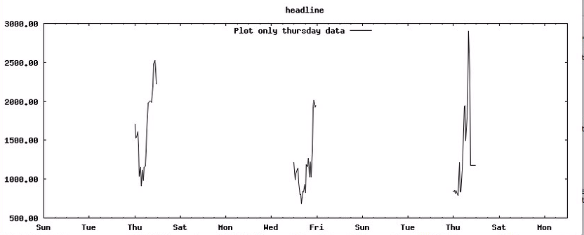

plot data from column 16 in your file and show only data when it is Thursday: (weekday=4)
using 1:(tm_wday(strptime("%Y%m%d%H",strcol(1))))==4 ? $16 : 1/0 with lines  lt 1 lw 1 lc rgb "#000000"  title "Plot only thursday data"    axis x1y1
and your data looks like: (dateStamp;datacolum;datacolum;...); with date-format=%Y%m%d%H
2016072021;123;2;0;0;0;0;72.0;88.2;33.35;29.4714285714;25.84;0.0;10.2352941176;9.64705882353;2245.99424242;61944.3060606;3408.64;61945.4;6533.21548387;9075.93;47644.8548387;47647.5;0.9;22.1910569106;22.0595041322;24.7508196721;0;0;2.0
Screen Shot 2016-08-30 at 00.12.41.png (84.49 KiB) Viewed 2420 times
