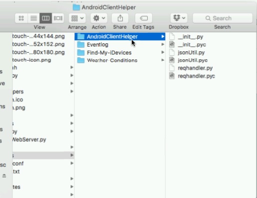

Yes, there apparently was a bug in the auto-update routine for the IWS plugin... Please download the v1.3.0 that I just posted and give it a try. Sorry about that!

Thanks Adam, I have installed the new 1.3.0 version and I no longer see the file location errors for the plugin, but Pairing is still failing from the mobile app with the same error. I can do everything else on the mobile app like view devices and control pages, I just can't pair my phone to the associated device. I also tried looking for the domopad page on the same server the indigo is installed on http://127.0.0.1:8176/AndroidClientHelper/ and after I log in, i get "undefined page requested"

Re: Can't pair android devices
Tried a full reboot of the mac and fresh start everything. opened the indigo page locally but AndroidClientHelper is not listed. I do have 3 other plugins listed but not yours. I have attached an image of the Plugin Dir in IWS.
I haven't forgotten about you... In fact, I was just able to somewhat duplicate your situation but haven't had time to determine the issue. One thing I thought of that might help - could you compare the permissions on the AndroidClientHelper versus one of the working plugins?
Just checked and they are all the same, user has read/write, admin and everyone have read only. This was working kind of previously, in that I could Pair the phone but the device would not update. I disabled the plugin and removed it and it's pref files from the system then re-installed fresh, this is when I got the file name errors and the plugin in the web server stopped working not allowing me to pair.RogueProeliator wrote:I haven't forgotten about you... In fact, I was just able to somewhat duplicate your situation but haven't had time to determine the issue. One thing I thought of that might help - could you compare the permissions on the AndroidClientHelper versus one of the working plugins?
I believe I found it... was missing a supporting file in the distribution, which is why existing installations that upgraded did not have an issue... would you please try this release and let me know if it works for you?
https://github.com/RogueProeliator/Domo ... v1.3.2.zip
That solved it in my environment.
Hi Adam,
That resolved my issue and I can now open plugin in browser and pair my phone. Thank you for your support in fixing this quickly.
