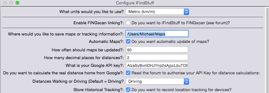

Here's a screenshot of my configuration fields:
iFindStuff Configuration for Historical Tracking
Screen Shot 2016-07-31 at 12.19.59.png (86.08 KiB) Viewed 18012 times
Notice that there is NO trailing '/' at the end of the folder path.

I am still getting Too Many Queries with Current Address even with the update and my setting were just like yours in the picture.
