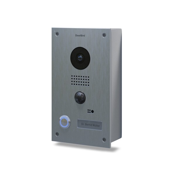

This is a review of the DoorBird remote entry communications system.
I have a home with a gate located around 80 meters, and out of view, from the house. For the past several years I have tried three different video communications systems. The first was an old black-and-white inter phone that worked fine until the audio fuzzed out. I then tried a mass-market color video-phone that supposedly could work over just 2-wires, and it barley lasted 3 months. The next effort was from a name brand (Legrand) company and also worked over a two wire connection. I had to run 2.5mm wire (like 10ga) and it lasted two years before the video died. This time I wanted to do it right, and besides getting a good quality picture, I wanted remote access via the Internet. I looked at the Ring andSkyBell after seeing them mentioned on this forum. Research on both the Ring and SkyBell left me a little underwhelmed and I had all but decided to just live with my, now audio only, system. But, after seeing the DoorBird, and in spite of it's price, I changed my mind and ordered one.
Here is what I found. The product is solid... I purchased the Stainless Steel (D201S) surface mount model (picture below) because it will be mounted in the open on a post and I was a little afraid of using plastic. However, all their models are exactly the same internally, they differ only in the case. The surface mount box for the D201 is nice and roomy so there is no trying to stuff lots of wires into the box and no need to cram the cover shut. Everything you could possibly need for a normal installation is required including scotchlock connectors and security screws with a matching screwdriver. Of course, in this price range it should be complete!
A test install in my house took under 5 minutes. The actual install at the gate took three days, but that was due to blocked buried conduits (I wanted to run ethernet/cat5e) and a host of other issues. The unit is fast to respond, has a high quality image and clear sound, though sound from the unit's speaker could be a tad louder.

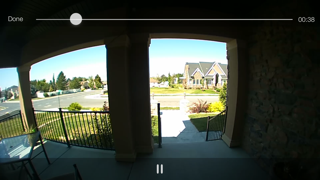

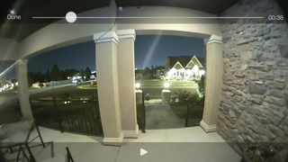

Nice review... with a profile like that mounted on a wood or stucco surface, I'd be tempted to router out a pocket and embed the doorbell at least 50% into the post/wall/whatever... then run a bead of weatherstripping around it (leave 1/8" all the way around for this). Might make it that much more difficult to pry off the wall.

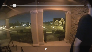

I'll be looking at one of these for my back porch. How is the night time image? I'm asking because the night time images from the Skybell are so good. I've included some Skybell samples (reduced in resolution for posting purposes... the originals go clear off the page):
Skybell Daytime, about midday.
Skybell Nighttime (with porch light)
Skybell Nighttime (dim hue porch light at 5%)
Thanks again for the review and I'd be interested in any picture quality samples although I could get these online if you'd rather not.

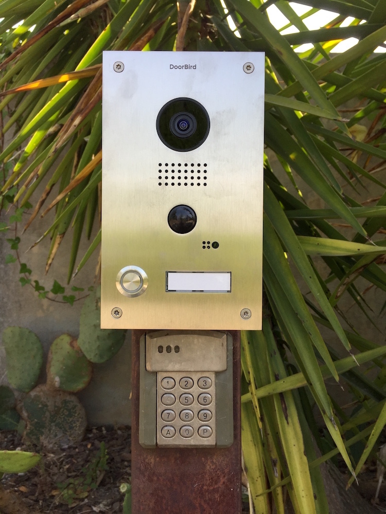

kimball, hamw and neilk all wrote:

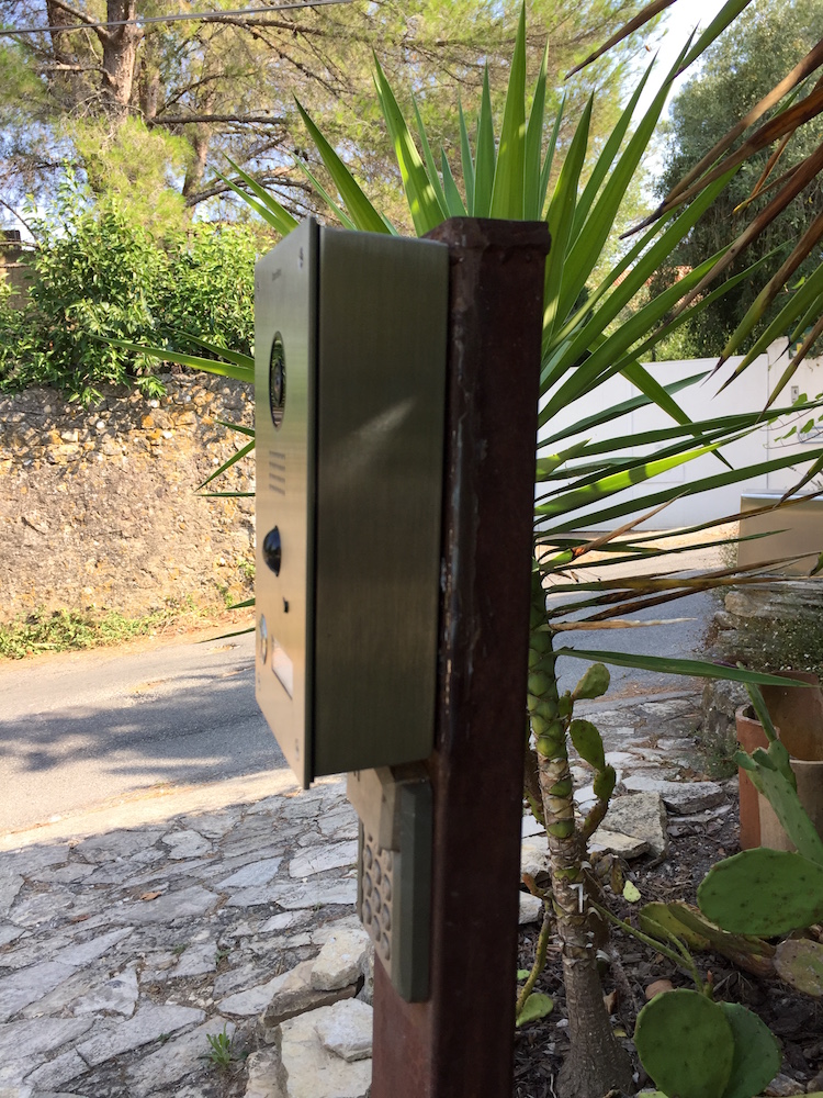

First, kimball wrote:... I'd be tempted to router out a pocket and embed the doorbell at least 50% into the post/wall/whatever... then run a bead of weatherstripping around it...
I would have loved to embed it to some extent. But, as you can see, that was not an option. BTW, if you order the flush mount version the case back is a lighter weight material more suitable for embedding in a wall.
Face View
Face View
Side View
Side View

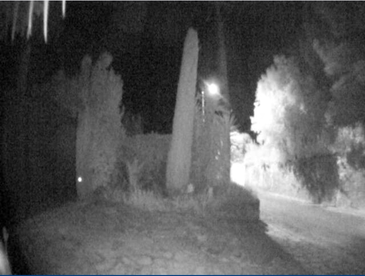

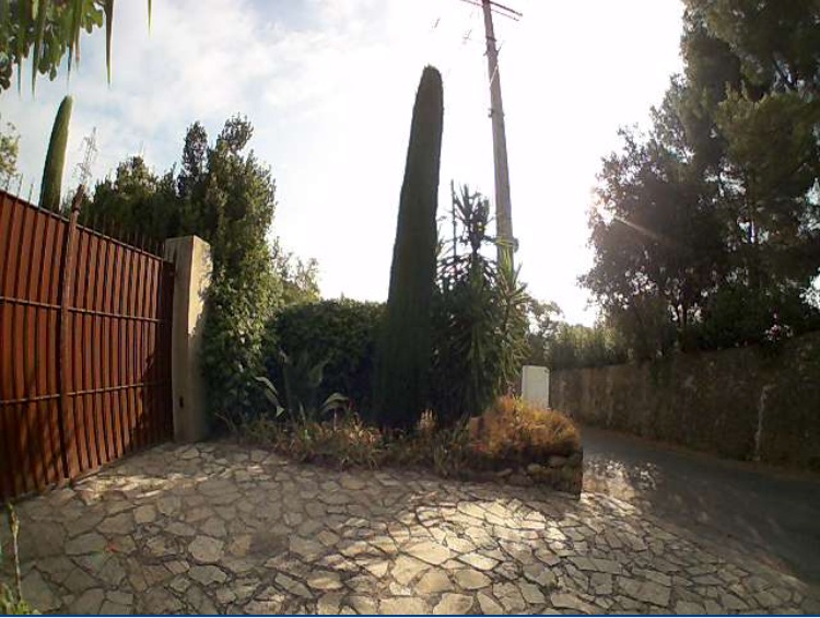

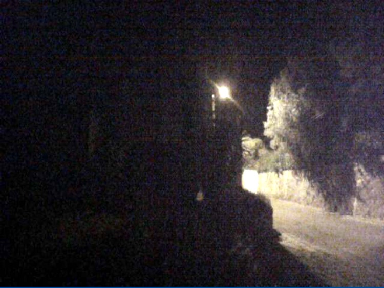

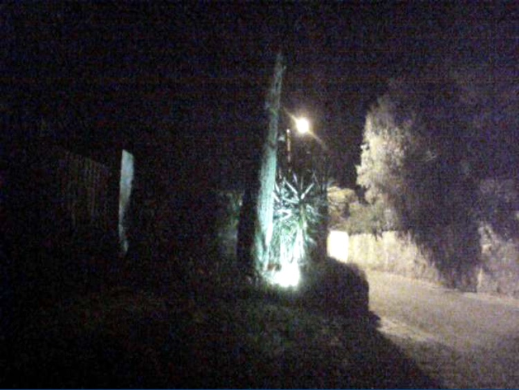

kimball also wrote:...How is the night time image?
Here are 4 views: Day, Night with one street lamp, night with the street lamp and a (5 watt LED) garden light (shining up on a tree) and night infrared. The night images are at a lower resolution because the server thought I was logged in more than 2 times. I need to get that worked out on Monday. Note that the area outside my gate is fairly dark and the pictures are all usable. Though not nearly as nice as theSkyBird's - though it had much better lighting.
Day
Day
Night
Night
Night with entry light
night B&W
night B&W
and then, hamw wrote:... [my unit] does not show things at night until the doorbell is pressed. ...Regarding your unit, when the doorbell is rung, what is a lag time following your notification, then opening the app to view the video feed? When you press the microphone button, is there a lag in voice transmission and does the audio reception ever overlap? Finally, I suppose that has http snapshot capability for indigo integration?
