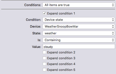

Select any Indigo device and then any device state to base your evaluation upon. In pseudo-code it works like this:
IF [device][state] [equals, not equals, greater than, less than, between, not between, contains, doesn't contain] [value(s) you specify] THEN condition = True
So, if you configured the condition as:
Conditions - Device State.png (38.39 KiB) Viewed 14736 times
Then it evaluates as:
IF WeatherSnoopBowMar  weather state contains the word 'cloudy' THEN condition is True
Therefor if the weather state equals "Cloudy", "Partly Cloudy" or "Mostly Cloudy" then the condition passes, but if it equals "Overcast" it does not.

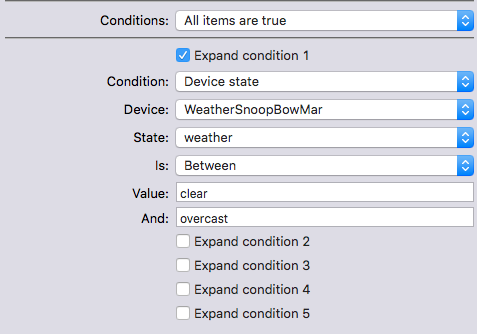

However if you had these options:
Conditions - Device State 2.png (42.51 KiB) Viewed 14736 times
Then if the weather state is "Clear", "Cloudy", "Mostly Cloudy" or "Overcast" then the condition passes, but if it was "Partly Cloudy" it would not.

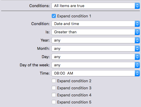

Date and Time
Only returns true when the date and/or time matches your criteria. This is pretty straightforward but there are some nuances to be aware of. One nuance is the use of "any" as the value in any date or time field. Using "any" indicates that you really don't care what the that value is. Take for example this configuration:
Conditions - Date Time.png (45.1 KiB) Viewed 14736 times
Evaluates as:
IF the time is between 8:00 AM and 11:59:59 PM then return true
It's important to know that when you are evaluating times open ended like this that it will evaluate only the current day, so every minute past 8:00 AM is greater than 8:00 AM, but midnight, which equates to 00:00:00, is less.

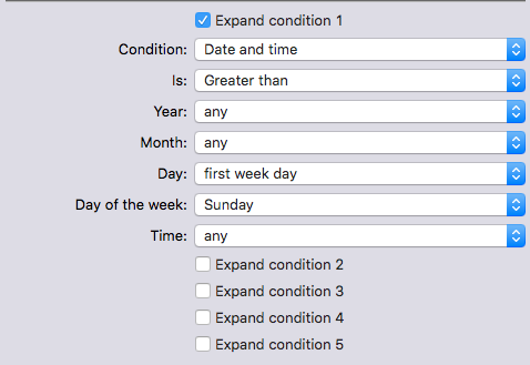

Another key feature of using date and/or time conditions is the ability to select variable dates. For instance:
Conditions - Date Time 3.png (41.48 KiB) Viewed 14736 times
Allows you set a condition based on if the current date is the first Sunday of the month. Similarly you can choose the second, third, fourth or last week day of the month as parameters.

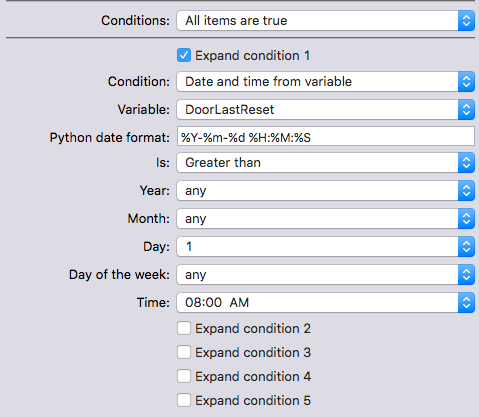

Date and Time From Devices or Variables
Evaluating a date and/or time from a device state or variable is the same as using the current date and/or time with the exception that you need to define how that date appears in that device state or variable. The date/time definition is based on Python date/time formatting and the default value will already be set to what the majority of dates and times used in Indigo already are: "%Y-%m-%d %H:%M:%S". If your definition is off, even by a single character, the evaluation will fail and an error will be logged in Indigo.
Conditions - Special Date Time.png (54.78 KiB) Viewed 14736 times

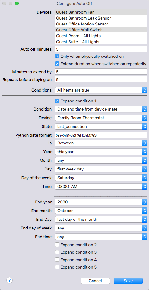

Stupidly Complex Condition from Powermiser
Screen Shot 2016-07-07 at 6.10.49 PM.png (127.17 KiB) Viewed 14724 times
Check Them Out Here
