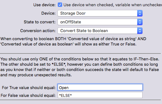

I thought I understood the instructions for converting State to Boolean.
But this isn't working. It reports as "false" whether I leave the false value *ELSE* or make it Closed. And I don't get a True if I open the sensor. What am I missing?
OnOffState to Open/Closed?

- Screen Shot 2016-06-12 at 12.08.46 PM.png (67.94 KiB) Viewed 3526 times

onOffState is already a boolean, so the configuration you posted says "If True = Open then Conversion = True Else Conversion = False". Since True never equals "Open" it's going to be false. If you are trying to reverse the states where when onOffState is False then Converted State is True, then you just put false in the first condition and true in the second (I actually use that a lot in my stuff because a lot of plugins reports some state backwards of what is useful to me).
It can be confusing because Indigo gives multiple options for booleans for ease of reading, so even though you SEE Open/Closed, Indigo still sees that as True/False with different names. There are a few of these in Indigo like On/Off is also just another alias for True/False.
So pretend that Open = True and Closed = False and try it like that.
Make sense?

Re: OnOffState to Open/Closed?
Ahhhh.
I think I was totally misunderstanding the point of the conversion!
I'm trying to get a status for the sensor to say "Open" instead of "On" and "Closed" instead of "False."
Looks like this plugin doesn't do that.

It doesn't current convert one value to a string equivalent but honestly that's pretty simple for me to add - and it's a good time too because I'm about to release an update to this plugin in the next few hours. Can you run that code and do a dump of the device so I can see what you are converting just so I know what I'm working with?Different Computers wrote:I'm trying to get a status for the sensor to say "Open" instead of "On" and "Closed" instead of "False."

Download the latest plugin, it's 1.4.3 (soon to be 1.5.0), see if the new conversion for "Boolean to string" does what you want.
Exactly and perfectly!Colorado4Wheeler wrote:Download the latest plugin, it's 1.4.3 (soon to be 1.5.0), see if the new conversion for "Boolean to string" does what you want.
As perfectly as can be in a separate device. I'm sure you know this has been long asked for. Until v7 comes out this is great.
