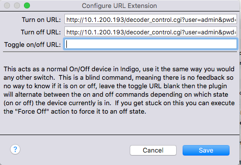

Because I have no life (and my wife is out of town and I have nothing better to do without her) I just added a new extension to Device Extensions called a URL Toggle Device. This basically allows you to create an On/Off/Toggle device that simply executes a URL for you on each command.
It just so happened that last night I was checking my cameras and noticed that the I/R was on for one of my cameras and it was close enough to glass to make seeing the image impossible, so I decided I would write something to easily take care of that for me but generic enough I could use it on a number of my web-enabled devices around the house.
Screenshot & Details
New URL Toggle Device
Screen Shot 2016-06-10 at 5.57.27 PM.png (63.74 KiB) Viewed 6768 times
  • Turn on URL: The URL to execute when an On command is received
  • Turn off URL: The URL to execute when an Off command is received
  • Toggle URL: The URL to execute when a Toggle command is received. If this is left blank then the plugin will internally just execute whatever command is the opposite of the current device state (i.e., if it is currently in an On state it will send an Off command). Because these commands are sent in the blind with no feedback from the receiver, a toggle command might perform the opposite action than what you expect - if this happens there is an action to force it to an off state (without sending an Off command) so you can reset it

Different Computers wrote:I'm not entirely following on the toggle intent
So you don't have to "turn on" or "turn off" only. For me my IR command button on my control pages is a single button, if I want to toggle IR on and off then I can use that. For schedules I have it set to "turn on" at dark and "turn off" at light. It just gives the same functionality to THIS device as other Indigo devices have.
