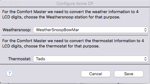

Do you have a thermostat defined in the Acme CP plugin? That error should only come up if the thermostat is not defined.
Here's a screenshot of my config using your thermostat and my Weathersnoop and I don't get any issues:
Screen Shot 2016-06-01 at 1.56.47 PM.png (42.55 KiB) Viewed 13007 times
My log shows pretty solid as well:
  Reloading plugin "Acme Future Home C-Panel System 1.2.0"
  Stopping plugin "Acme Future Home C-Panel System 1.2.0" (pid 23269)
  Stopped plugin "Acme Future Home C-Panel System 1.2.0"
  Starting plugin "Acme Future Home C-Panel System 1.2.0" (pid 55464)
  Started plugin "Acme Future Home C-Panel System 1.2.0"
