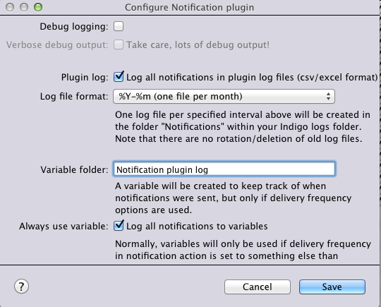

Plugin configuration
From within Indigo, go to Plugins menu, choose Notfication plugin and Configure...
Plugin config dialog
Plugin config.png (58.62 KiB) Viewed 7152 times
This should be pretty straight-forward. The plugin will in some cases (if you configure it later on) use variables for storing notification history, or if you choose the option to always use variables. For this a specified variable folder will be used.

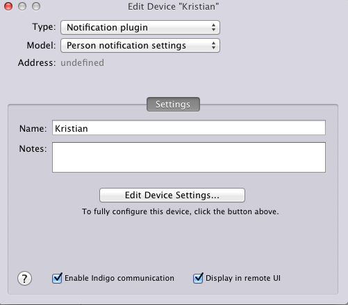

First, you should set up the persons in your home, the ones that will receive notifications.
Add a new device in Indigo, choose type Notification plugin and model Person notification settings
Add person device dialog
Add person.png (32.25 KiB) Viewed 7152 times

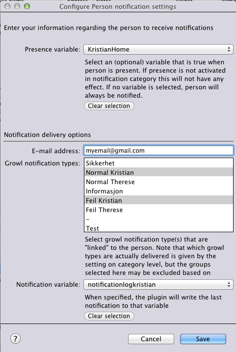

Person configuration dialog
Person configuration.png (75.68 KiB) Viewed 7152 times
Now we're on to the "contact" settings for the person. The idea is that you only have to set up this one place, and if something changes you don't have to go through all your notification actions to update settings.
Presence variable should be set to a value that is true when person is present, false if the person is not present, updated by the presence tracking system of your choice. If you don't specify a variable, person will always be treated as present.
E-mail address is the personal e-mail address
Growl notification types needs a little explaining. Choosing the growl types here does not mean directly that notifications are delivered to this person. This creates a link to "personal" growl types that will be used when sending out notifications (which will be specified later). This is better to explain under the notification category section.
Notification variable. If you choose to select a variable here, notifications for this person will be written to the specified variable, which yoy may create your own triggers off etc.

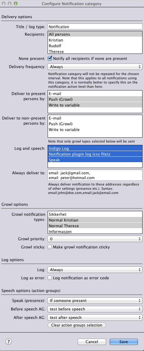

Setting up notification categories / types
This is where most of the configuration is done. Idea is that you create different categories/types of notification and specify the delivery options there. When you later on create the notification action, all you have to do is select the category, enter the notification text and you're set to go. Again, one central place to change the relevant settings etc. To start, choose to add a new Indigo device, type Notification plugin and model Notification category
Notification category configuration
Configure notification category.png (113.69 KiB) Viewed 7152 times
Title / log type is used to name log entries and/or e-mail subjects, growl notification titles etc., if not overriden later on.
Recipients. Select the persons to notify for this category. Use cmd button to select/deselect multiple
Notify all if none present. Meaning that if no-one is actually present when the notification is triggered, all persons selected above will be notified instead.
Delivery frequency. Selecting this means that no notifications of this category will be delivered for the specified interval (log entries will always be written regardless). It is generally better and recommended to specified this on the notification action level (later on)
Deliver to present and non-present options. Select what methods you would like to use for notification of present vs non-present persons. If both present and non-present should be notified, choose your method(s) in both lists.
Log and speech: Select the options you would like used
Always deliver to: Here you may specify additional e-mail recipients that will always be notified regardless of presence settings etc., but have to be within chosen delivery frequency (if specified). Reason for email: syntax is future-proofing for adding other delivery methods.
Growl notification types needs a little explaining wrt logic. The logic is as follows:
- Initially, the growl notification types selected here are used for delivery
- If you have chosen to only deliver growl to present persons, and one or more of the chosen growl types are "linked" to non-present persons, those groups will be excluded from delivery
You may specify growl priority and sticky properties.
Log: You may choose to always log or only if someone is present. You can also choose to log notification as an error in Indigo log.
Speak: Same as above, choose to always speak or only if someone is present. You can also (optionally) specify action group(s) for execution before and/or after speak
So, that's the notification category. A lot of settings and tweaking is possible, but the idea is that you have to do less settings for each of the notifcations as most settings are changed in the category.

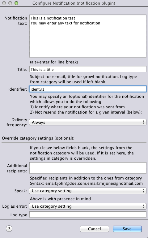

On to the actual notification action. From a trigger or action group etc., select action type Notification actions -> Notification (notification plugin) and select the notification category you would like to use. The only mandatory field is notification text, others may be left as-is to use the settings given by the notification category.
Action configuration
Action configuration.png (77.52 KiB) Viewed 7152 times
Notification text: Enter your text for the notification. You may use %%d:DEVICEID:STATEKEY%% to get device state substitued, and %%v:VARID%% to get variable value, as described here (substitute function)
Title is optional.
Identifier allows you to set a unique identifier for this particular notification. This again allows the plugin to determine when this notification was last sent, and is required for the delivery frequency to work.
Delivery frequency allows you to specify how often the notification should be delivered (log entries will always be made). Note that this is independent from the setting in category, and it is generally a better option to specify it here on the action rather than on the category level.
Override section allows you to override the category settings. If left as-is, settings from the category will be used.
That's it when it comes to settings.
