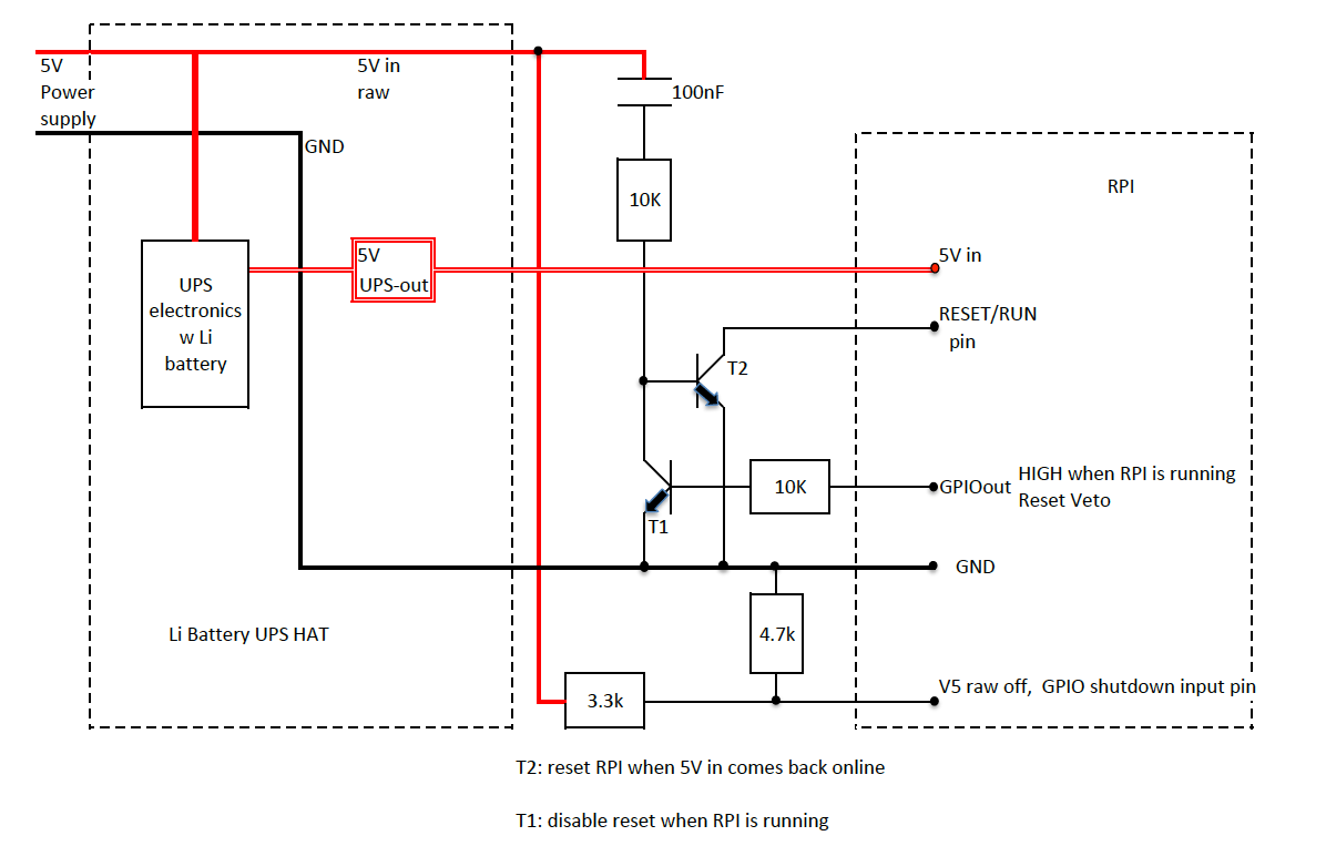

Re: piBeacon: 6- tips and tricks
issue: when RPI shuts down, it does not restart on its own when power is not interrupted.. need to connect reset pin to ground to do that.
The attached drawing should do that automatically.
If you have an RPI UPS HAT for the RPI: here a way to reset the RPI when +5V comes back online.
setup:
1. when +5V raw goes down, RPI starts counter (connect +5V raw to GPI-IN through resistor divider), When > 1 hour time w/o raw power, do auto shutdown.
2. when +5 raw comes back: T2 gets triggered (through R 10k+C100nF ) and the RPi resets = starts
when RPI is running a GPIO output pin is set high and disables T2 through T1. This disables shutdowns eg when you have a short power interruption.
setup:
- Screen Shot 2018-11-13 at 22.14.17.png (66.42 KiB) Viewed 9140 times
==== with RPI UPS HAT and this little piece of electronics you have ==== ====
- backup power of several hours
- soft / controlled shut shutdown before battery runs out
- restart when +5V per is back
this actually works!!
with the RPI UPS HAT you can have a battery back that can keep the RPI running for xx minutes = keepRunning(*) (set in rpi device edit) (3.7Ah = 12 hours for an rpiZero W)
after keep running is expired and +5V raw is not back the rpi will do a soft shutdown.
T2 will pull the "reset/RUN" pin down for some millisecs when +5Vraw is back and start the RPI
While RPI is running T1 will short the basis of T2 so that any change of V+5 raw does NOT trigger a reset / run.
Normally when the RPI (like the MAC) was shutdown in a regular way and power is still present (battery is still a charged) while shutting down it can only be restarted through a power cycle or a reset/run short to ground

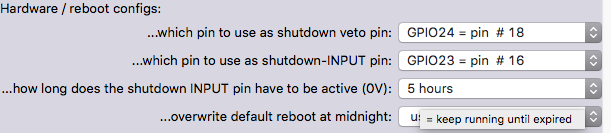

To setup: in RPI device edit define
= shutdown input pin
= shutdown output pin
= keepRunning time
I was thinking about this for some years.. it finally works.
Will be working out the kinks(***), but this is very promising.. It will keep the SSD cards alive (damage due to wild power shutdowns) And will cover power failures ...
(*)how long does shut down input pin have to be active (= 0 Volt on R 3.3k) == keepRunning time
(***) things like : if power comes back for a short period of time and goes on/off while battery is not yet charged ie can not run for eg 5 hours
