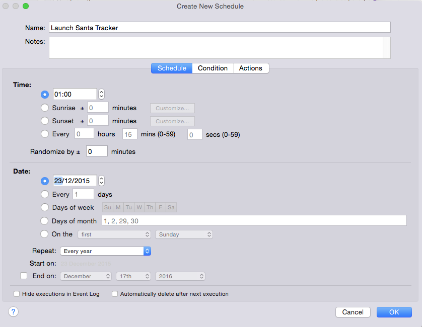

    4. Create a schedule trigger for 23rd December at 1am
    Schedule trigger
    Schedule trigger
    Screen Shot 2015-12-19 at 10.37.18.png (86.21 KiB) Viewed 3104 times

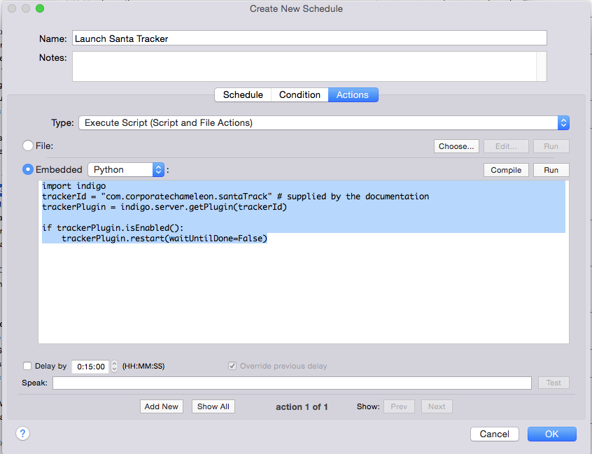

    5. Now add an action that executes a script. On the Actions tab this is a Server Action>File and Script Action>Execute Script and add the following code as an embedded Python script:
    import indigo
    trackerId = "com.corporatechameleon.santaTrack" # supplied by the documentation
    trackerPlugin = indigo.server.getPlugin(trackerId)
    if trackerPlugin.isEnabled():
    	trackerPlugin.restart(waitUntilDone=False)
    Restart code
    Restart code
    Screen Shot 2015-12-19 at 10.39.32.png (80.22 KiB) Viewed 3104 times
