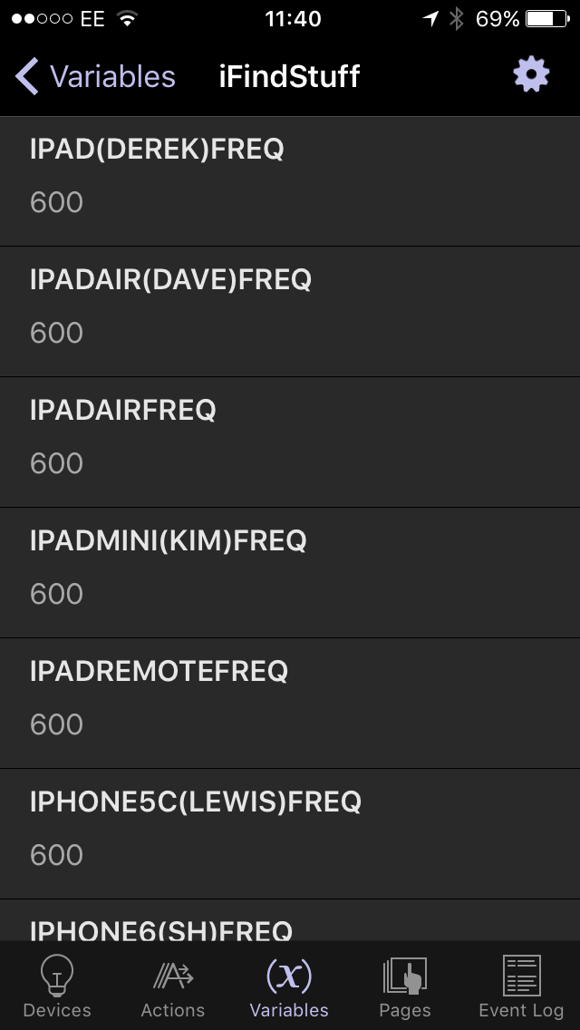

:? Hi Mike,
Thanks for the new Bug Fix, something completely unrelated, was just looking through the Device States & Variables on my iP6, can you tell me what the below means and what it can be used for?
Keep up the good work
Regards,
Dave

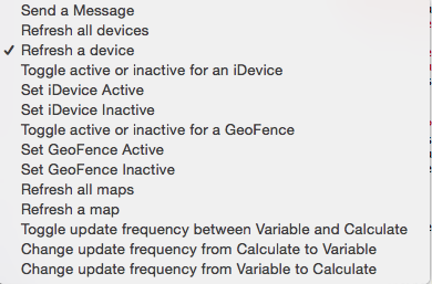

Sure
The update frequency of a given device can either be calculated (default) or driven by a value contained in the [NAME OF DEVICE]FREQ variable. This was a request from a user a few weeks ago and is used mainly for links with FINGScan. When you define an action group and use an iFindStuff command you have a number of options:
iFindStuff Commands
iFindStuff Commands
Screen Shot 2015-11-15 at 12.03.27.png (40.09 KiB) Viewed 7471 times
The last three commands allow you to change the way that the update frequency is worked out - Calculated (as default) or Variable. If you set a device to be managed by a variable it uses the refresh value in the associated variable for that device otherwise it calculates the next update based on the factors that are set in the Device Configuration.
This feature could be used if you wanted to check a device every min at a specific time of day or if you wanted another event in some other part of Indigo to trigger a more regular update for a period.....

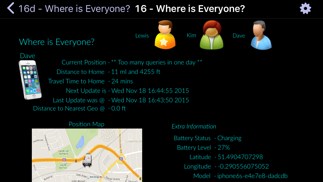

Hi Mike
The plugin reset itself overnight with Google as expected, so the "To Many's" went away....but at approximately 4pm today they came back, again I have no errors in the log. I checked the Google Maps Developer API and I have not exceeded my calls....
Any ideas???
Cheers
Dave
