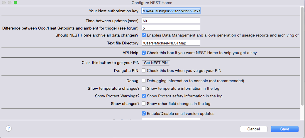

  • 1. Go to the NEST Home configuration dialogue with Plugins/NEST Home/Config... and you should get a dialog like this one:
    NEST Home dialog box
    Screen Shot 2016-08-06 at 15.03.11.png (110.71 KiB) Viewed 2656 times
    2. Now make sure that the API Help?: checkbox is checked like in my example and the Click this button to get your PIN button will be displayed
    3. Click the button!

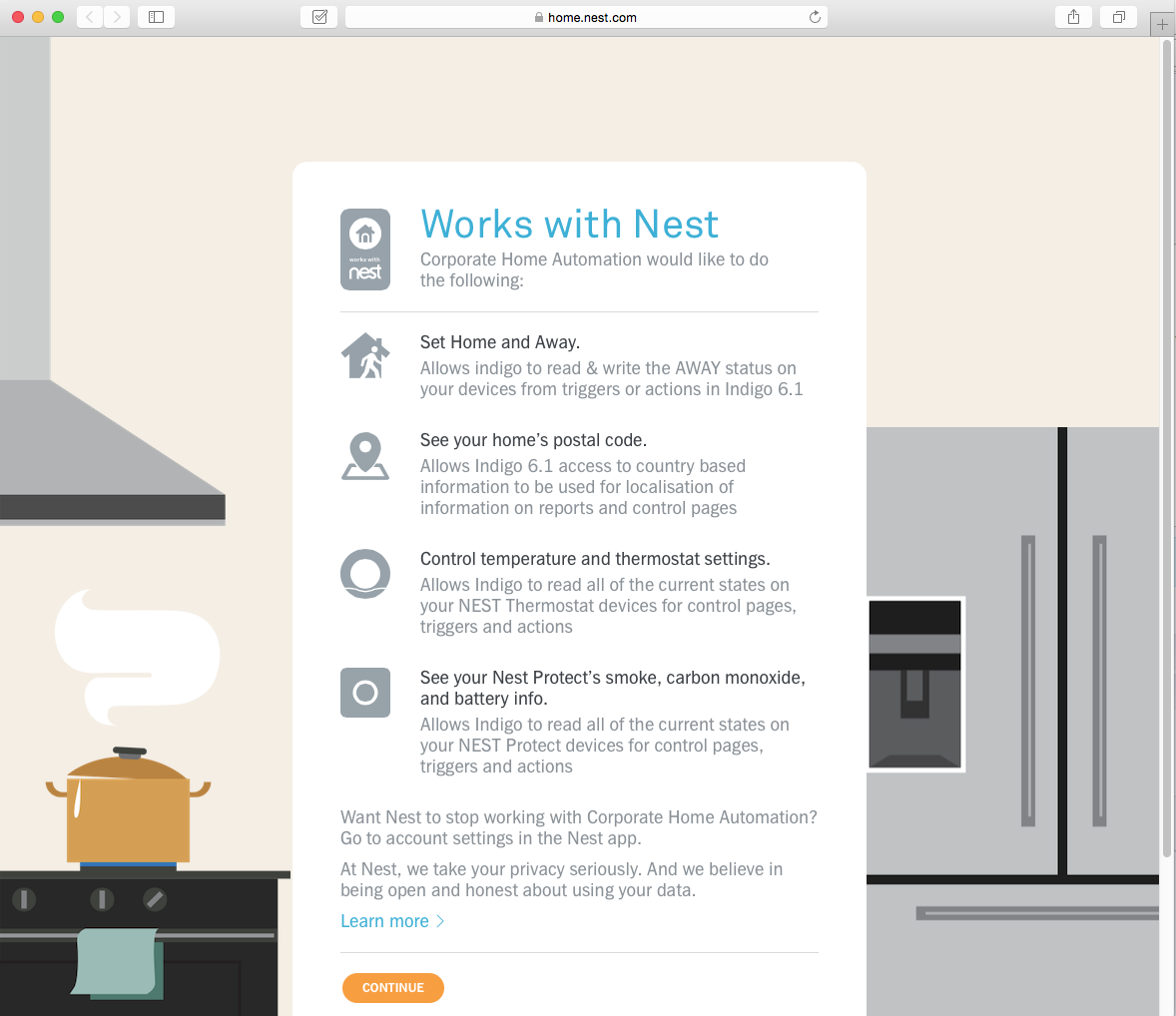

    4. After a few seconds, it should respond by opening your browser to the home.nest.com page
    5. You will then get a permissions page which you have to accept if you want to use NEST Home. It looks something like this:
    NEST Permissions on home.nest.com
    Screen Shot 2016-08-06 at 15.06.45.png (180.05 KiB) Viewed 2656 times

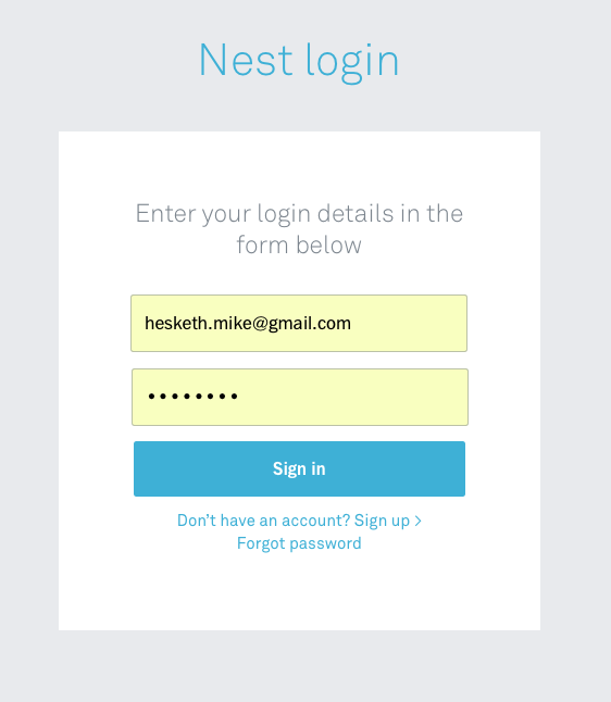

    6. Click Continue and you will get the login screen like this:
    home.nest.com - login screen
    Screen Shot 2016-08-06 at 15.10.06.png (34.88 KiB) Viewed 2656 times
    7. Login using the normal username and password for your domestic account where the NEST Protects have been registered and click Sign-in

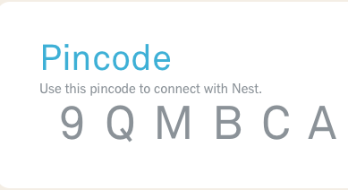

    8. The site will respond with an eight digit code similar to this:
    NEST Home PIN Display
    Screen Shot 2016-08-06 at 15.11.58.png (17.48 KiB) Viewed 2656 times
    (I've removed the last two digits for security reasons :-))
    9. Highlight the code and copy it to your clipboard (i.e. Command+C or Edit/Copy - you can now close your browser

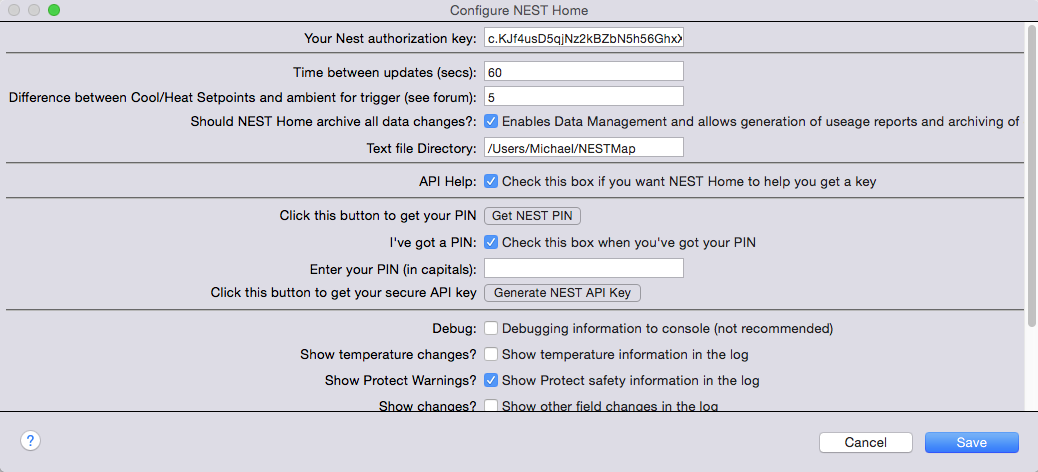

    11. Check the I've got a PIN box and two new options will appear like this:
    NEST API Generate Screen
    Screen Shot 2016-08-06 at 15.15.44.png (114.94 KiB) Viewed 2656 times
    12. Now click into the Enter your PIN in capitals field and either paste the clipboard Command+V or Edit/Paste. Alternatively, you can just type in the PIN that was displayed in the web browser!
    13. Finally, Click - Generate NEST API Key and NEST Home should automatically grab you a unique secure key and paste it into the Your NEST Authorisation field at the top of the dialog
    14. Click Save

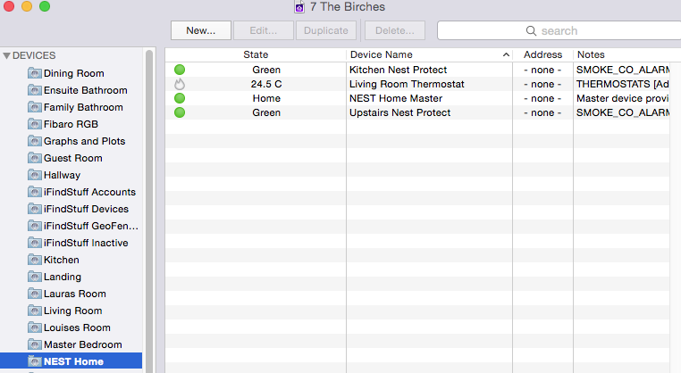

    15. Now wait and see what happens. It should automatically create a new folder under devices called NEST Home, create a Master Device and a new device for each of your Protects based on the name you entered during your registration on the home.nest.com site. Something like this:
    NEST Home Devices
    NEST Home Devices
    Screen Shot 2016-08-06 at 15.21.53.png (80.87 KiB) Viewed 2656 times
Don't be surprised if it doesn't create the folder and devices immediately - it can take up to 10 mins for the first login. After that, it simply maintains the devices based on what's in your account automatically. Basically, it mirrors your account so if you've got 4 Protects (all versions 1-3 are supported) then those are the devices it will find in your account and create. If you delete a device in your account or rename it or even add something else (protect, thermostat or camera) it will change your Indigo setup to match.
