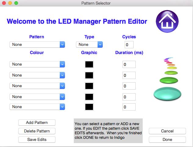

LED Manager Pattern Generator
Screen Shot 2015-10-30 at 16.30.45.png (82.55 KiB) Viewed 7255 times
From here you can Add a new pattern, Edit an old one or Delete the pattern completely. I've added a default one called Alarm by clicking on the drop down in the top left and this is how it's displayed...

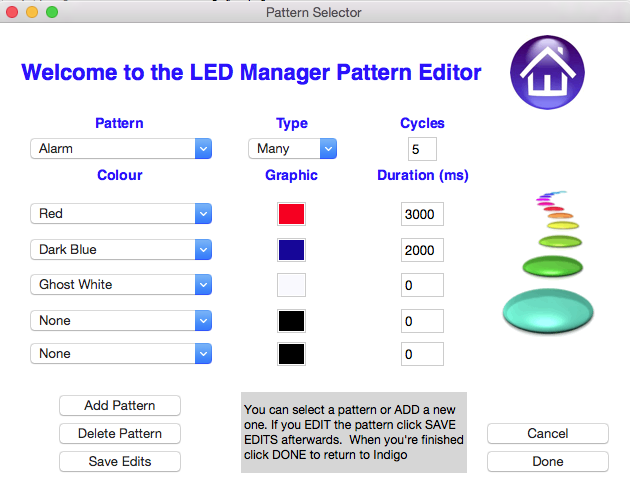

Typical Pattern
Typical Pattern
Screen Shot 2015-10-30 at 16.31.33.png (85.58 KiB) Viewed 7255 times
If you change the settings (colours or durations) then don't forget to click Save Edits or they will be lost,.

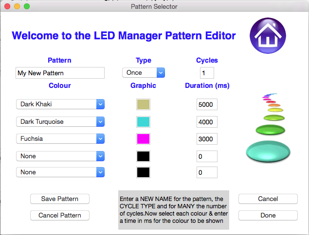

If you click Add Pattern you can create your own. I've created one here called New Pattern
Creating your own pattern
Screen Shot 2015-10-30 at 16.32.42.png (88.77 KiB) Viewed 7255 times
First entry a cycle type from the dropdown next to the name you've just entered.... You've a choice of Once, Many or Forever which I think are self explanatory. I don't recommend you use Forever as it will keep on going until you stop the plugin. If you select Many then you can enter the number of times it should run in the next box.
Use the dropdowns to select colours and enter durations for how long they should be displayed (in milliseconds) in the box on the right of each colour. You can stop at any point leaving the None in the colour box. BTW if you look carefully you'll also see that your saved colours have been included in the list (see last update)

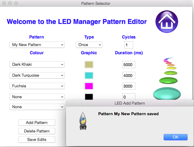

Finally save the pattern...
New Pattern Saved
New Pattern Saved
Screen Shot 2015-10-30 at 16.33.08.png (86.74 KiB) Viewed 7255 times

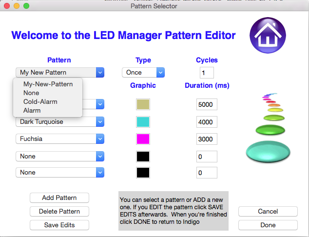

Now you'll see that your pattern is in the list...
In the list (note -s)
Screen Shot 2015-10-30 at 16.33.30.png (96.09 KiB) Viewed 7255 times
Notice the '-'s in the name. These have been added as indigo doesn't like spaces in dictionary key names so these replaced any spaces you've put in and still keeps the names readable.

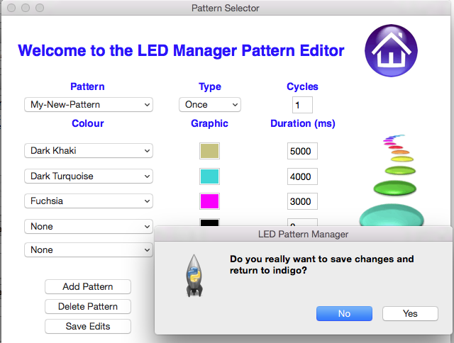

Once you completed your edits, adds and deletions then click Save. If you click Cancel then all of the changes that you've made in that session will be lost.

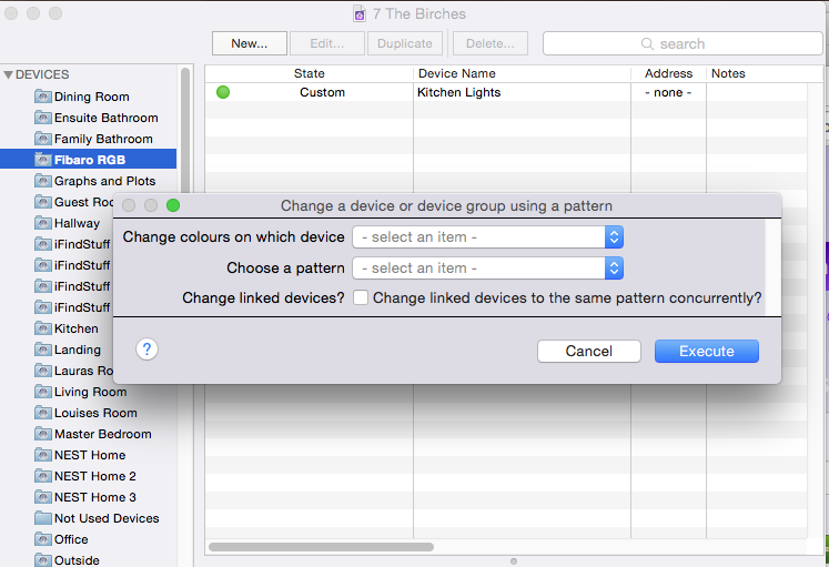

Now you've created some patterns you can apply them to devices. You can either use the menu option or create an action.
Menu Option
Menu Option
Screen Shot 2015-10-30 at 16.45.37.png (115.92 KiB) Viewed 7255 times

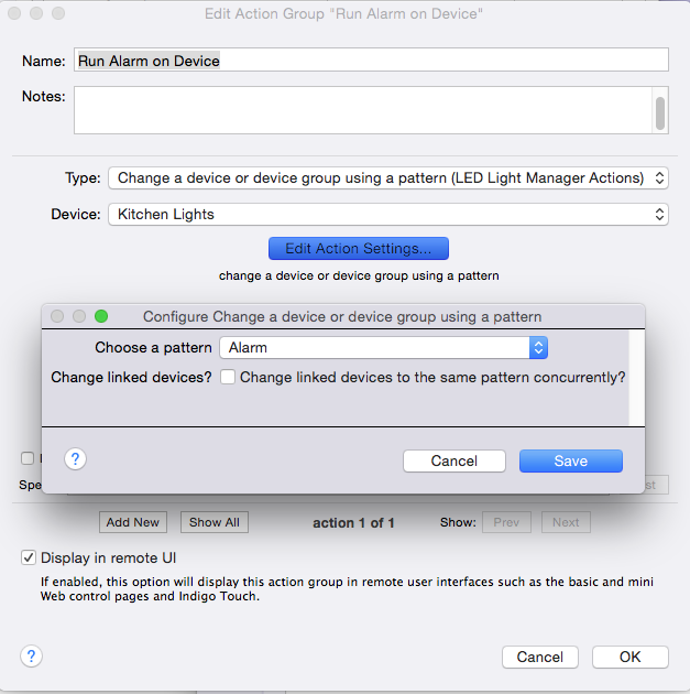

or action
New Action Command
New Action Command
Screen Shot 2015-10-30 at 16.44.11.png (97.07 KiB) Viewed 7255 times
One last thing. You'll notice that you're given the opportunity to apply the pattern to all linked devices in a group. If you select this option ALL of the devices in a single group will change colour :)

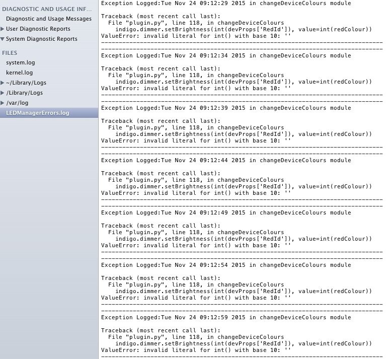

Here you go, tried adjusting the ms durations to smaller numbers and still doesn't work.
Screen Shot 2015-11-24 at 9.12.49 AM.png (112.1 KiB) Viewed 6749 times

toille27 wrote:Here you go, tried adjusting the ms durations to smaller numbers and still doesn't work.
Thanks for that - very helpful.
This tells me that for some reason one of your patterns is corrupt in the text file and it's causing this problem. I've trapped this error now so that it won't cause the same problem to your system BUT that doesn't resolve the corrupt pattern in the file. As I'm not sure how it was created I've added a new feature to the plugin to resolve it.
First I recommend that you install the latest version 0.3.41 from the link in the latest software post.
Then you have two options:
  • a) Run the Add, Edit or Delete Pattern menu option and delete the pattern that's causing the issue and then recreate it (remember to save your changes)
    or
    b) Run the new command Purge the Patterns Database to remove corrupt data. This will reset the patterns file to blank and you can then recreate your patterns again.
Let me know how it goes
