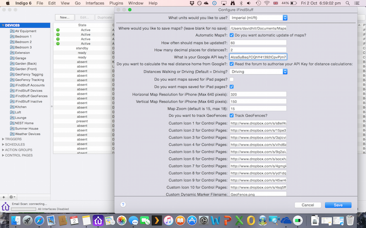

Great work, one little issue I've spotted re F37 you have the same text for iPad Maps, see screenshot

Thanks Dave - I've uploaded 1.0.36 correcting this error :D
